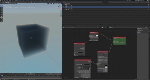

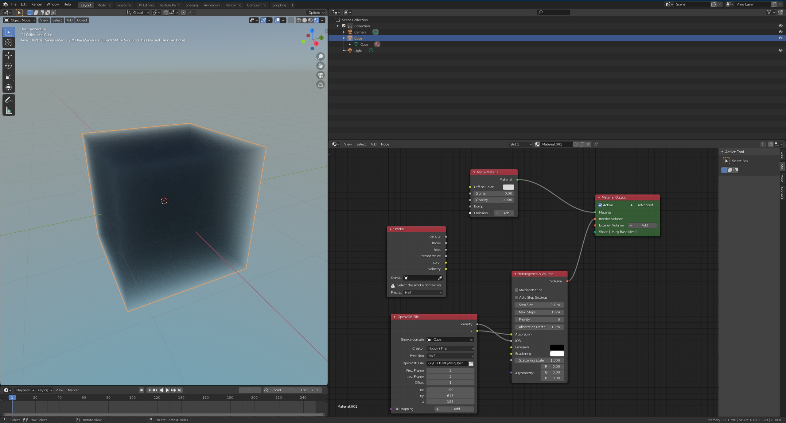

Please excuse my incompetence with Python coding. How can I use these Python code into my Blender/LuxCoreRender setup?
Attached a simple setup where I used a .vdb file that I found on the Web. With VDB giles the domain works. I wish I could do the same with the unlinked (for now) smoke NODE.
I am very interested in what LuxCoreRender and Blender can achieve with volumetrics, so I wish I can learn how to use it properly.
I have attached a screenshot of my very primitive setup and the related blender file.
Thank You very much for your help

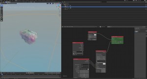

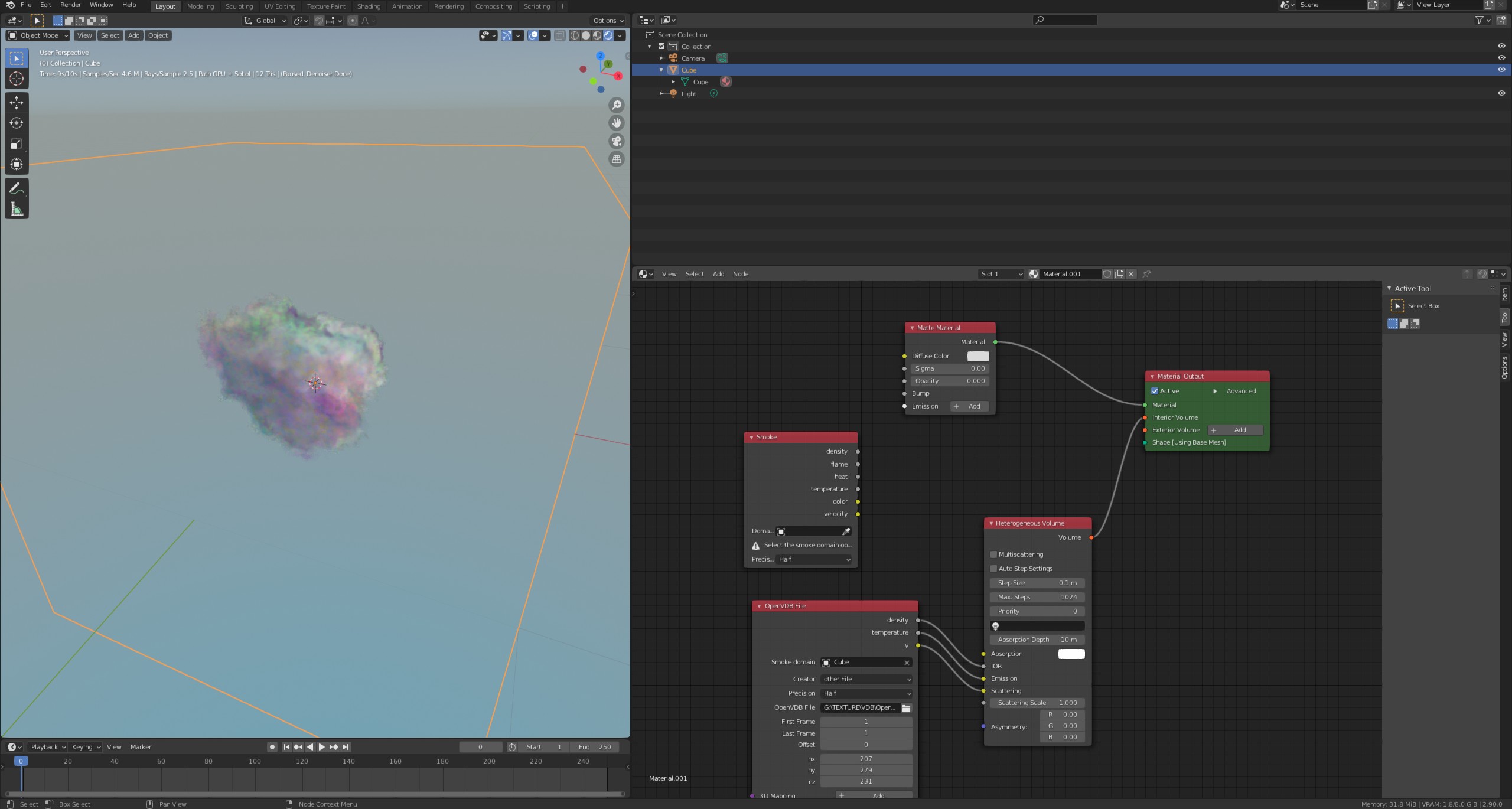

Very wrong setup (bad inputs), but much better results, in this VDB there is also a temperature value and I plug it into emission, obtaining something more realistic.

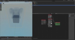

Hi! Just set up the smoke domain with a Blender smoke simulation, and all went ok. Very basic setup screenshot attached.
and the Flame, Heat, Temperature, Color, and Velocity input, where they can be plugged to obtain best effects? Maybe to a color ramp?
Thanks again and bye
