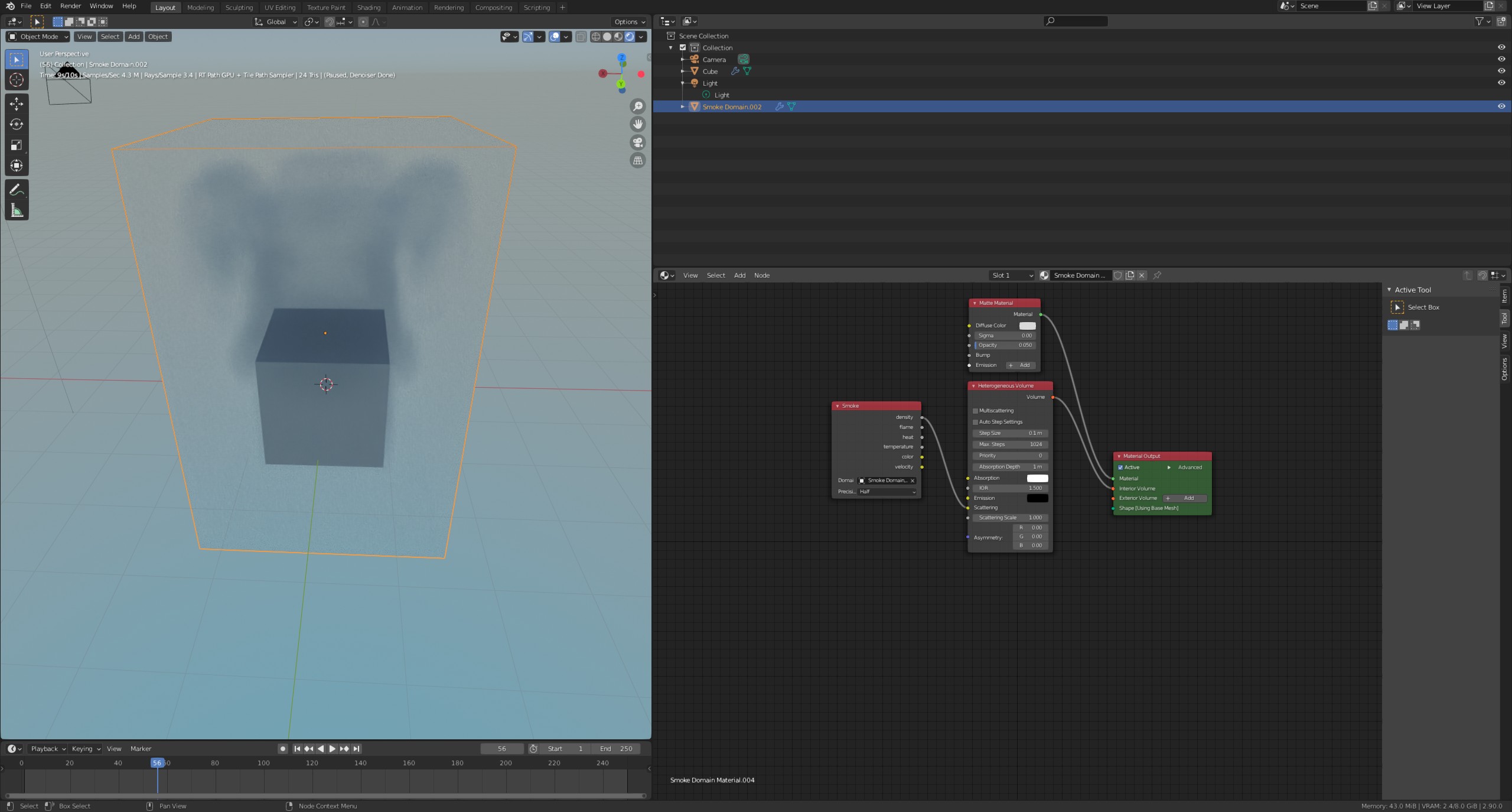

Hi! Just set up the smoke domain with a Blender smoke simulation, and all went ok. Very basic setup screenshot attached.
and the Flame, Heat, Temperature, Color, and Velocity input, where they can be plugged to obtain best effects? Maybe to a color ramp?
Thanks again and bye
