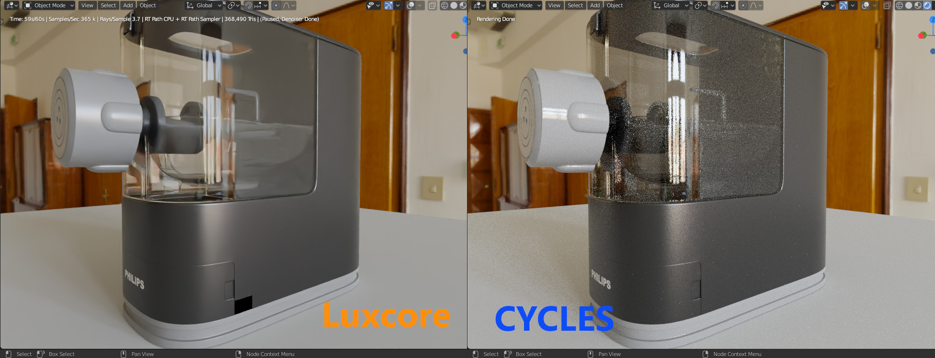

I struggling with a dark poly spot in my model in both blendluxcore 2.4 / 2.5 on CPU / GPU not in Cycles:
Dade PM you with the file.

Exporting the scene to file system and rendering with LuxCoreUI works fine. The problem is visible only inside Blender.
Try to isolate the polygon with the problem and erase everything else.

The triangles have NaN UV coordinates:

This is a .ply file directly exported from Blender without the use of any LuxCore related code. It is a Blender bug as far as I can see.
You can report the problem to Blender developers by providing this file a telling them to export in .ply format and check the UV coordinates (aka ST coordinates).
However they may be not able to track the problem from there because the NaN may be the result of the process used to build the mesh (so they may be unable to track what tool is broken and has generated the NaN).

Ok so a simple unwrapp can fix the issue :D And it work !
