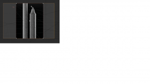

i played arround with the shader and imported an old model to try out the shader.
But the shader doesnt work and i cant find out whats going wrong.
On the left is just a cylinder on the right the imported model, both using the same shader
i attched the blend-file
luxcore wax.blend
(875.74 KiB) Downloaded 263 times

The surface normal of your candle are flipped inside. In case you don't know how to fix this: tab into edit mode, select all surfaces and press "shift + n"
The translucent materials seem to work in an unidirectional way, see this issue on GitHub I opened recently:
https://github.com/LuxCoreRender/LuxCore/issues/427

Thank you, sometimes the simplest things are overlooked.
