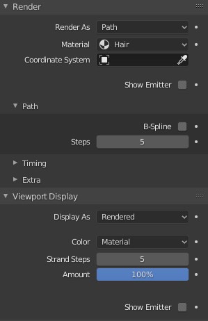

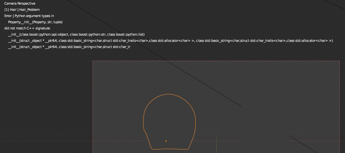

I find strange bug while trying to transport scene from Cycles to LuxCore. All materials and meshes work fine, except hair. It gives me error notify (pic 1). In other scene simple hair works pretty fine. Sometimes changing values in hair render and viewport menu (pic 2) let me render hair in viewport . But I didn't find any dependency between these moments. In blend file hair cause problems are disabled, just try to enable-disable it.
Error text:
Python argument types in
Property.__init__(Property, str, tuple)
did not match C++ signature:
__init__(class boost::python::api::object, class boost::python::str, class boost::python::list)
__init__(struct _object * __ptr64, class std::basic_string<char,struct std::char_traits<char>,class std::allocator<char> >, class std::basic_string<char,struct std::char_traits<char>,class std::allocator<char> >)
__init__(struct _object * __ptr64, class std::basic_string<char,struct std::char_traits<char>,class std::allocator<char> >, double)
__init__(struct _object * __ptr64, class std::basic_string<char,struct std::char_traits<char>,class std::allocator<char> >, int)
__init__(struct _object * __ptr64, class std::basic_string<char,struct std::char_traits<char>,class std::allocator<char> >, bool)
__init__(struct _object * __ptr64, class std::basic_string<char,struct std::char_traits<char>,class std::allocator<char> >)

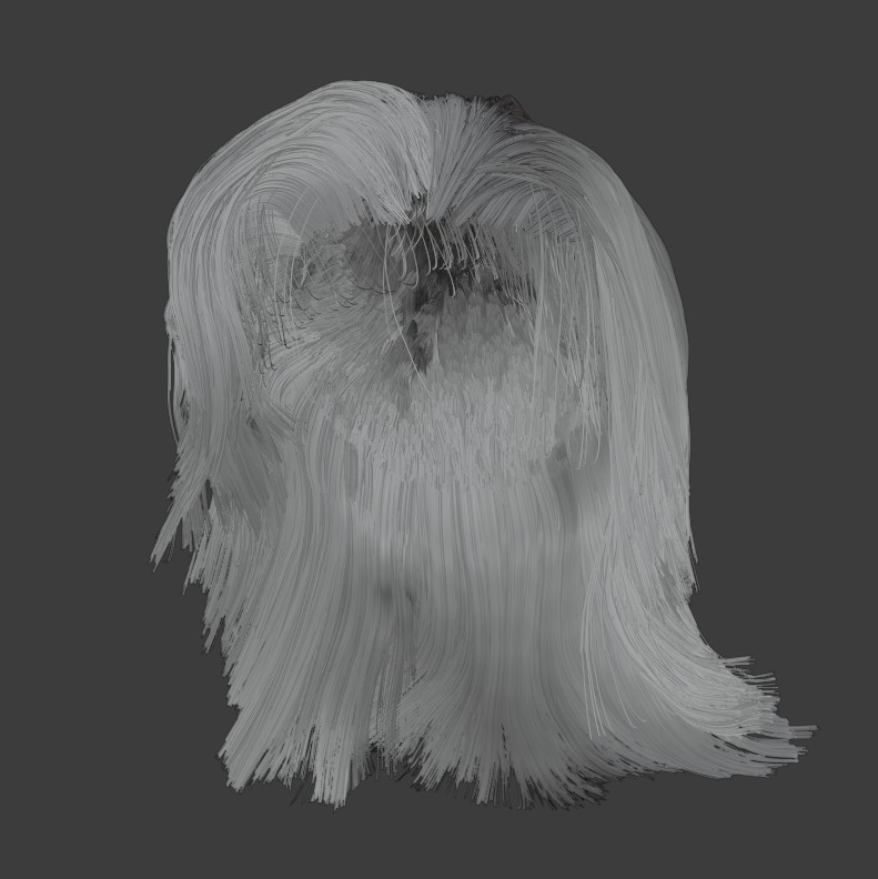

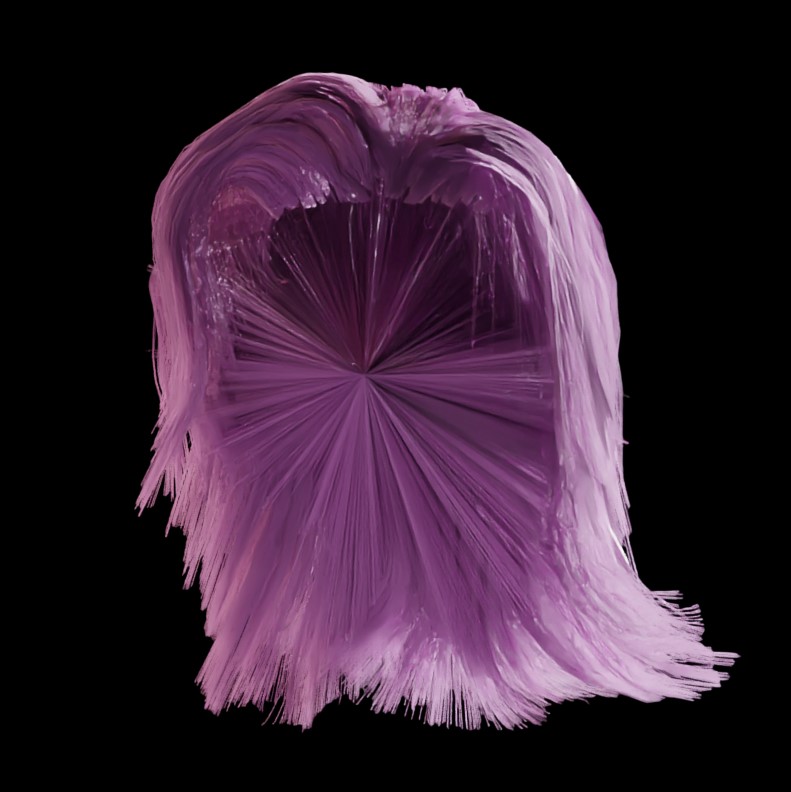

So I did like you said - now problem is solved and everything works fine except one thing. In viewport some strands align to center of coordinates. You can see it on screenshots below.
Re: Hair Strand Step Bug
DionXein wrote: Mon Aug 24, 2020 12:48 am In viewport some strands align to center of coordinates.
This is a known bug, unfortunately not yet solved: https://github.com/LuxCoreRender/BlendL ... issues/408
