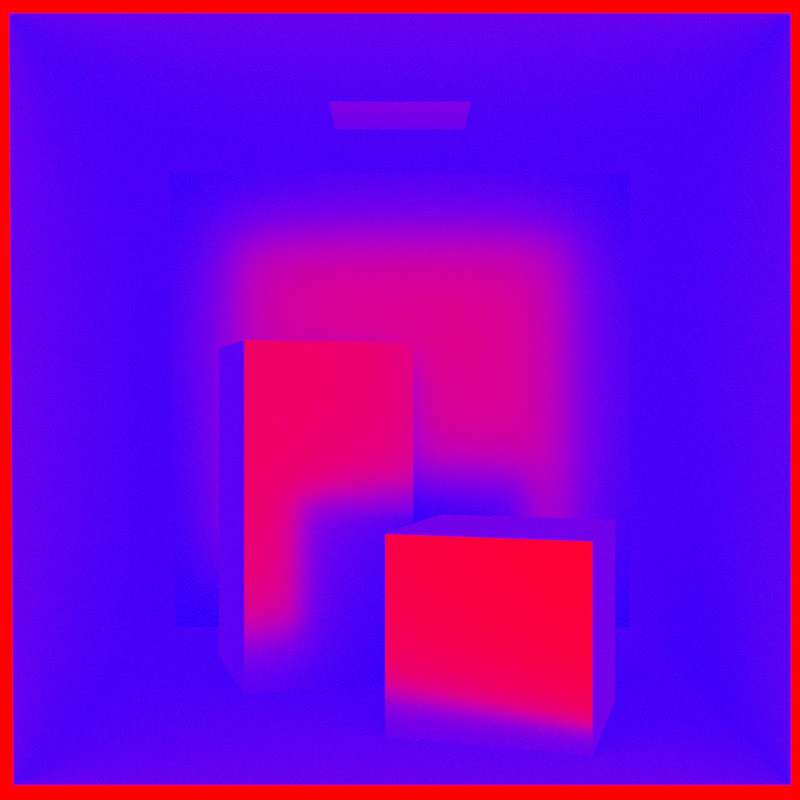

Dade wrote: Sat Aug 15, 2020 5:13 pm With 1 nothing special, if you set to 0.0, it will disable brute force path tracing so the cache will be always used (i.e. the debug image will be all blue).
Uhmm... it doesn't seem all blue. Where am I wrong?

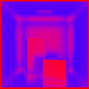

This is a glossy Cornell box with 8.0:
and this with 0.0:
The difference is pretty obvious, how is in your case ?
The red zone with 0.0 are there because Cornell scene is open and the rays bouncing over the front faces and hit the sky (as I wrote, the indirect cache can kick in only from the second bounce).
Is your room scene open ?

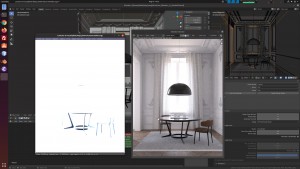

Dade wrote: Sun Aug 16, 2020 10:55 am The difference is pretty obvious, how is in your case ?

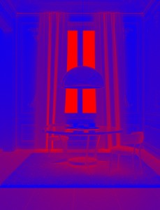

This is the scene you sent me with 8.0:

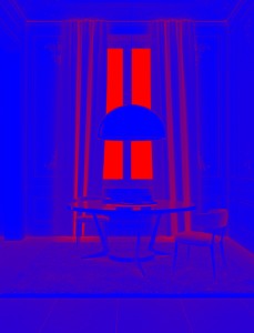

and this with 0.0:
marcatore
Posts: 463
Re: PhotonGI cache
Post by marcatore »
About the room you've already checked how it's done. In any case it's a normal two closed room with one window (opened) each room.
About your image...well.... I'd like to have something like you've got.
I've opened the scene I've sent you.
To avoid possible problems with the 2.9, I've opened the scene with 2.83.4 and, as the previous tests, I'm using latest BlendLuxCore 2.5 alpha.

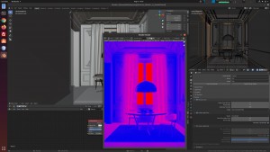

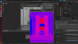

I've changed "normal angle" to default 10° and set brute force radius scale to 0 and this is what I've got.
Re: PhotonGI cache
marcatore wrote: Sun Aug 16, 2020 11:44 am About your image...well.... I'd like to have something like you've got.

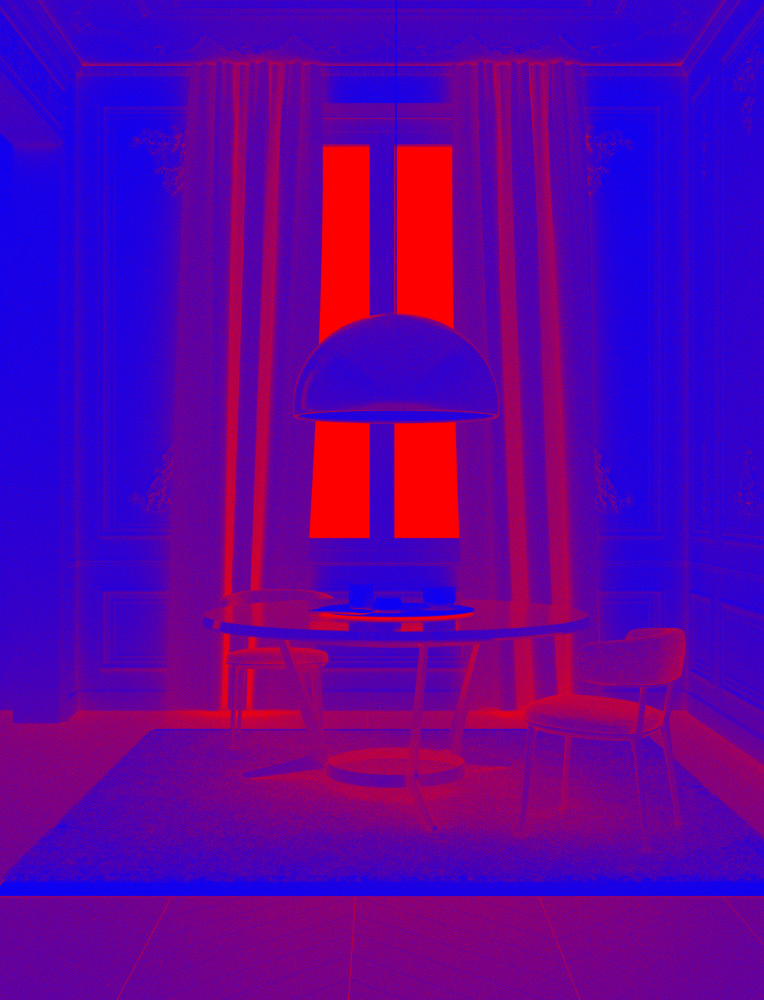

This is with 8 inside blender with your parameters:
and this with 0:
The difference is there and is large.
There is a difference with the results I posted because they were rendered outside Blender without the color curve re-map/post-processing your scene seems to have.
This is a normal rendering outside Vs inside Blender:
As you see, you are doing some kind of heavy tone mapping/color curve re-mpapping/post-processing. Indeed, you should render the debug images without any post-processing or your perception may be heavily screwed.
