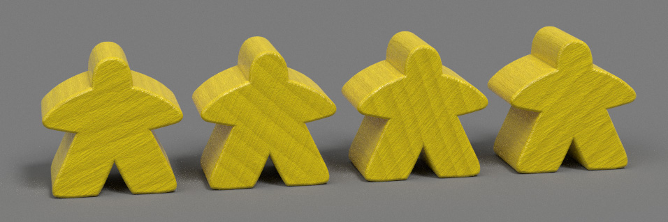

Here's an example where randomized UV rotation comes in very handy. This are instances of the same object (same material of course) and all the wood grain is oriented differently, as it is in real life. I sometimes have dozens of them in scenes and this variance makes all the difference.
Re: Histogram-preserving Blending for Randomized Texture Tiling (aka Procedural stochastic texturing)
AndreasResch wrote: Fri Aug 28, 2020 2:40 pm Here's an example where randomized UV rotation comes in very handy. This are instances of the same object (same material of course) and all the wood grain is oriented differently, as it is in real life. I sometimes have dozens of them in scenes and this variance makes all the difference.
Ok but I was talking of the "Tiling" section of the UI panel: Randomized UV and Randomized Tiling are somewhat 2 separate and uncorrelated topics.
AndreasResch
Posts: 135
Post by AndreasResch »
Dade wrote: Fri Aug 28, 2020 3:11 pm
I understand. But if you look at that Randomization dialog from Corona, it has a randomize option for the W axis. So with 1 tile and W randomization turned on, you will get the same result, right? Having some randomization in the Triplanar Mapping node would do the job as well.

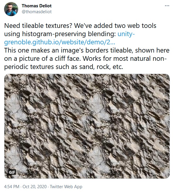

Heads up... tools are available in a web browser.
source: https://twitter.com/i/status/1318566180546879489
Tool to Make your texture tileable with histogram-preserving blending
"Disclaimer: this is a CPU implementation that runs in javascript. The GPU implementation presented in the paper is orders of magnitude faster. "
So yeah, thanks again to everyone involved in implementing it! 8-)
