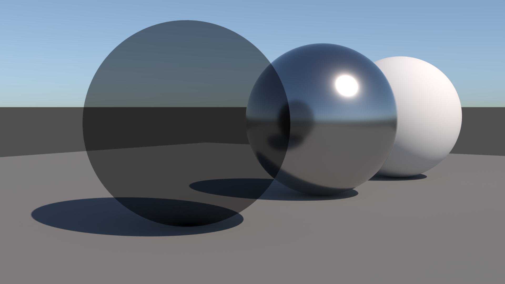

Quick question about glass. I tried creating a simple glass material and applying it to a sphere (foreground) and, well, I failed.
Material is defined as:
scene.materials.glass_test.type = glass
scene.materials.glass_test.kr = 0.2 0.2 0.2
scene.materials.glass_test.kt = 0.5 0.5 0.5
Should there not be specular reflections? Clearly I've missed something obvious. Can someone steer me in the right direction?
Cheers,
Jon
PS. Not trying to do volume rendering here -- just a thin glass surface.
GlassTest.zip
(2.28 MiB) Downloaded 276 times

You need to define the glass index of refraction (aka IOR) with the property ".inetriorior": https://github.com/LuxCoreRender/LuxCor ... ll.scn#L23

Ah, got it, thanks. I'd assumed the default value (1.5) would take effect.
Follow up question: What's the physical meaning of kr and kt? I assume kr is a multiplier that acts on the specular-reflection component (which is determined by IORs)? And kt acts on the non-reflected remainder? Just want to make sure I understand the physical basis. (I can also check the source code if this isn't documented elsewhere :).)

jon wrote: Wed Aug 26, 2020 12:20 am Follow up question: What's the physical meaning of kr and kt? I assume kr is a multiplier that acts on the specular-reflection component (which is determined by IORs)? And kt acts on the non-reflected remainder? Just want to make sure I understand the physical basis. (I can also check the source code if this isn't documented elsewhere :).)
They are the specular reflection and transmission scale factors. You can set both to (1.0, 1.0, 1.0) for a perfect specular transmission/reflection without any kind of attenuation.

Perfect. Thanks, Dade.
