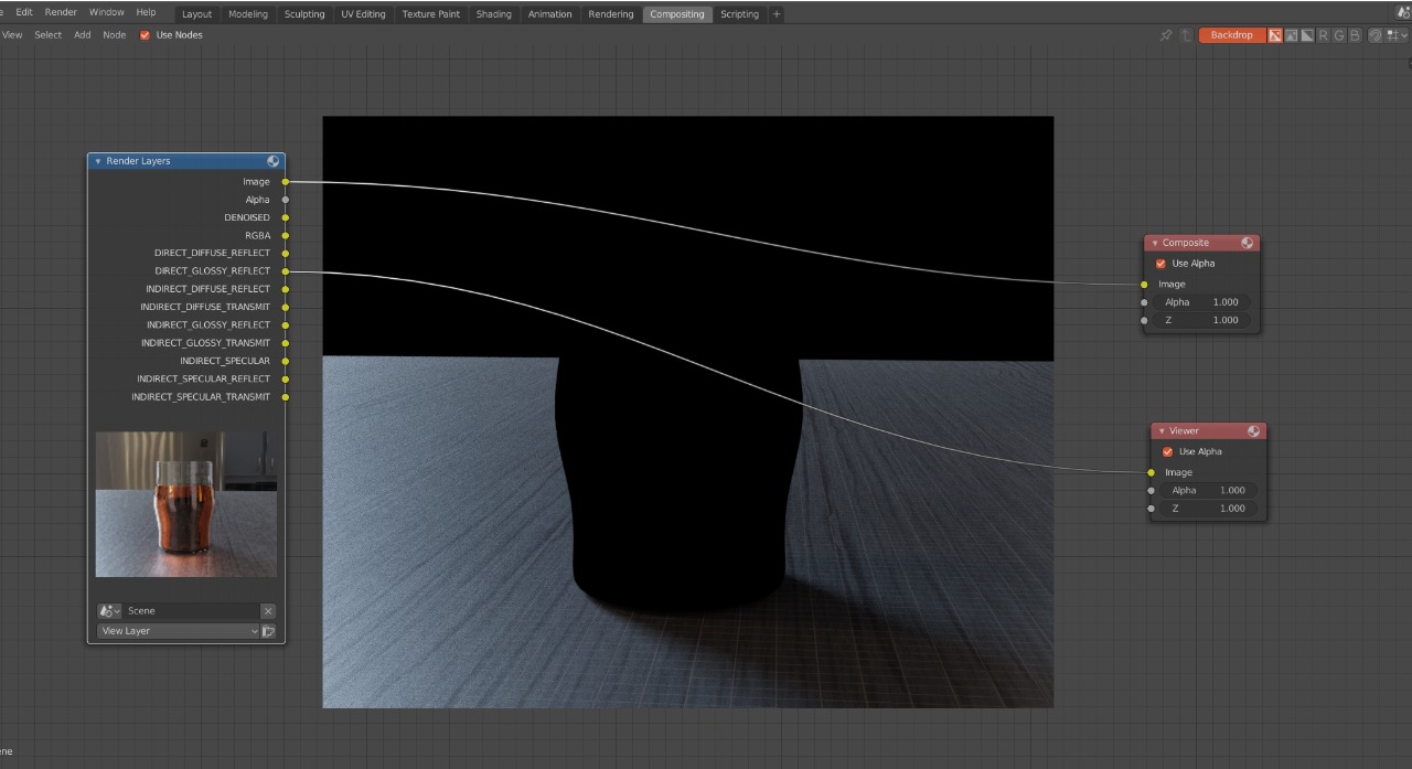

Hello Dade. How are you? I can't see my "Indirect Specular Transmit" and other AOVs passes. It appearing all black. I'd tested with Blender 2.82a and 2.90 with Luxcore 2.5 Alpha version - and in both versions it's the same issue. How can I render or see this "Refraction"(Indirect Specular Transmit) pass. There's something wrong here. Follow images to see what's happening. Thanks a lot!

jfcalcena wrote: Mon Aug 24, 2020 6:29 pm I can't see my "Indirect Specular Transmit" and other AOVs passes. It appearing all black. I'd tested with Blender 2.82a and 2.90 with Luxcore 2.5 Alpha version - and in both versions it's the same issue. How can I render or see this "Refraction"(Indirect Specular Transmit) pass. There's something wrong here. Follow images to see what's happening.
Are you using Glass material or something else ? Can you post a test scene ?

Dade wrote: Mon Aug 24, 2020 6:50 pm
Yes Dade, I'm using glass material in both mesh. In liquid and in the glass. Just fast preset selection to make some test in this AOVs passes. Nothing complex. My machine setup here is i7-8700K, 64RAM and 2 GTX 1080Ti (Windows 10), just in case. Follow We Transfer link file with my (Canada - HDR) together. The zip file it's too big.
https://wetransfer.com/downloads/6af30e ... 922/df0616
Thanks again!
Re: New Reflect/Transmit AOVs
jfcalcena wrote: Mon Aug 24, 2020 7:31 pm Yes Dade, I'm using glass material in both mesh. In liquid and in the glass. Just fast preset selection to make some test in this AOVs passes. Nothing complex. My machine setup here is i7-8700K, 64RAM and 2 GTX 1080Ti (Windows 10), just in case. Follow We Transfer link file with my (Canada - HDR) together. The zip file it's too big.
@B.Y.O.B.: this looks like a BlendLuxCore bug, the SPECULAR Reflect/Transmit AOVs seems to do nothing. DIFFUSE/GLOSSY Reflect/Transmit buttons works while nothing change in the configuration for SPECULAR Reflect/Transmit buttons.
Dade wrote: Tue Aug 25, 2020 11:17 am @B.Y.O.B.: this looks like a BlendLuxCore bug, the SPECULAR Reflect/Transmit AOVs seems to do nothing. DIFFUSE/GLOSSY Reflect/Transmit buttons works while nothing change in the configuration for SPECULAR Reflect/Transmit buttons.
The specular reflect/transmit AOVs are missing from pyluxcore.FilmOutputType.names.
This is causing the problem.
>>> pyluxcore.FilmOutputType.names.keys()
dict_keys(['RGB', 'RGBA', 'RGB_TONEMAPPED', 'RGB_IMAGEPIPELINE', 'RGBA_TONEMAPPED', 'RGBA_IMAGEPIPELINE', 'ALPHA', 'DEPTH', 'POSITION', 'GEOMETRY_NORMAL', 'SHADING_NORMAL', 'MATERIAL_ID', 'DIRECT_DIFFUSE', 'DIRECT_DIFFUSE_REFLECT', 'DIRECT_DIFFUSE_TRANSMIT', 'DIRECT_GLOSSY', 'DIRECT_GLOSSY_REFLECT', 'DIRECT_GLOSSY_TRANSMIT', 'EMISSION', 'INDIRECT_DIFFUSE', 'INDIRECT_DIFFUSE_REFLECT', 'INDIRECT_DIFFUSE_TRANSMIT', 'INDIRECT_GLOSSY', 'INDIRECT_GLOSSY_REFLECT', 'INDIRECT_GLOSSY_TRANSMIT', 'INDIRECT_SPECULAR', 'MATERIAL_ID_MASK', 'DIRECT_SHADOW_MASK', 'INDIRECT_SHADOW_MASK', 'RADIANCE_GROUP', 'UV', 'RAYCOUNT', 'BY_MATERIAL_ID', 'IRRADIANCE', 'OBJECT_ID', 'OBJECT_ID_MASK', 'BY_OBJECT_ID', 'SAMPLECOUNT', 'CONVERGENCE', 'SERIALIZED_FILM', 'MATERIAL_ID_COLOR', 'ALBEDO', 'AVG_SHADING_NORMAL', 'NOISE', 'USER_IMPORTANCE'])
>>> "INDIRECT_SPECULAR" in pyluxcore.FilmOutputType.names.keys()
True
>>> "INDIRECT_SPECULAR_TRANSMIT" in pyluxcore.FilmOutputType.names.keys()
False
>>> "INDIRECT_SPECULAR_REFLECT" in pyluxcore.FilmOutputType.names.keys()
False
I added them.
