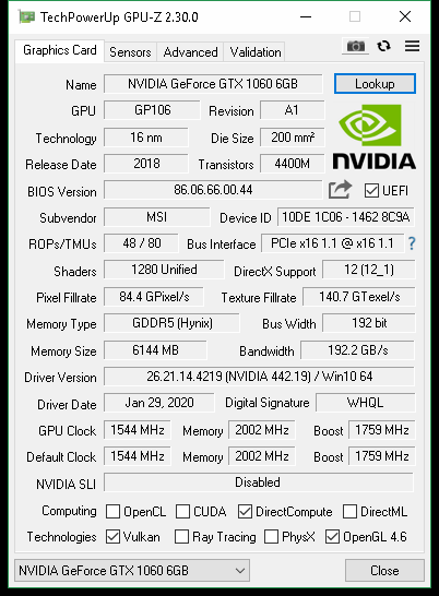

Yesterday I installed Windows 10 Pro x64 1607 build 2017 rus. I download latest Nvidia driver v451.67 (Game ready & Studio also too). I installed first GR version first. But in GPU-Z it dont show CUDA option is not enabled. And exactly, also on Blender 2.79+ (2.8, 2.81, 2.82, 2.83 and 2.90 too) in User Pref it dont enabled Cuda option too. On my previous Win7 x64 all are worked fine as well with v441.87 driver.
Really strange.
Please, help me to solve.
Thanks."

It is really strange, GPU-Z show you GTX 1060 but it says CUDA is not available I think it is not even possible to have NVIDIA drivers without CUDA

Here GPU-Z screenshot (I installed Nvidia driver one by one v442.19, v451.67 and v451.77 studio and GR too) and used DDU (Display driver uninstaller for clean uninstalling from system): Blender also write error while I opened Blender and checked console:

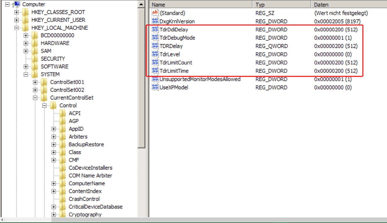

While I posted above messages I noticed/remembered that I changed regedit some settings as I used E-Cycles too (from bliblubli instruction). I added this "red bordered" settings into regedit and after remove it shows CUDA
