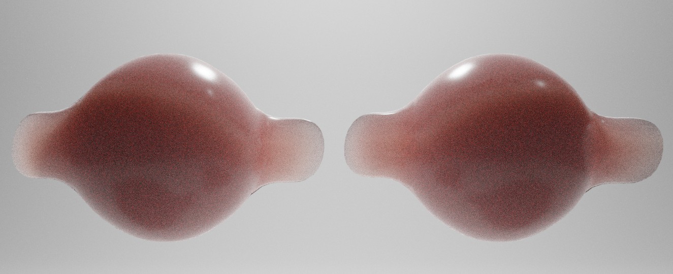

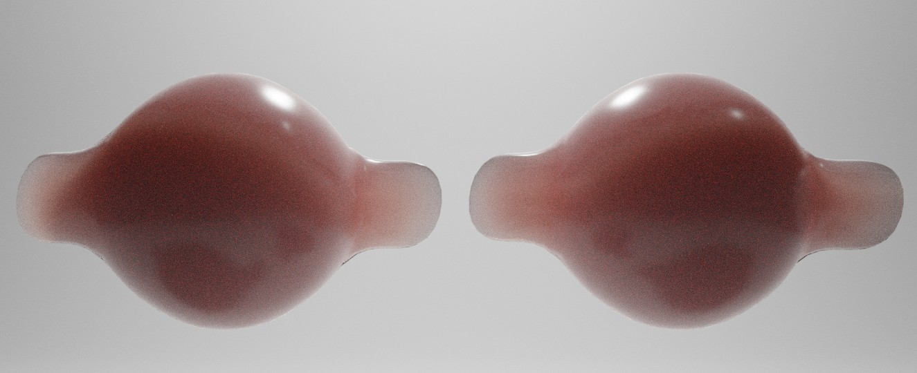

For some reason double side option with volumetric object seem to provide brighter looking result :
normal

Double sided
