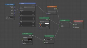

Interesting, I did it like this, is it the best way?Dade wrote: Sat Jul 04, 2020 10:09 am You don't need to mix different materials, just mix textures and plug the result in glass transmission color.
Re: Colored gradient glass
Yes, that was my idea.JulianoLisboa wrote: Sat Jul 04, 2020 1:24 pmInteresting, I did it like this, is it the best way?Dade wrote: Sat Jul 04, 2020 10:09 am You don't need to mix different materials, just mix textures and plug the result in glass transmission color.
- Posts: 146
I expressed myself badly. The idea was yours, the question would be, did I execute your idea correctly?Dade wrote: Sat Jul 04, 2020 1:43 pmYes, that was my idea.JulianoLisboa wrote: Sat Jul 04, 2020 1:24 pmInteresting, I did it like this, is it the best way?Dade wrote: Sat Jul 04, 2020 10:09 am You don't need to mix different materials, just mix textures and plug the result in glass transmission color.
Yes, it resembles my idea.JulianoLisboa wrote: Sat Jul 04, 2020 1:50 pm I expressed myself badly. The idea was yours, the question would be, did I execute your idea correctly?
