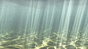

So my question is how to make a very basic scene with underwater volumetric caustics like in example scene "Underwater Paintings".
I've already downloaded the example scene, but I dont understand how a mesh without thickness can have a volume, and I cant also replicate the results in my scenes. When I try to replicate the volumetric caustics, they are not so obvious and barely visible. However, caustics in sand are very visible.

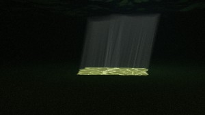

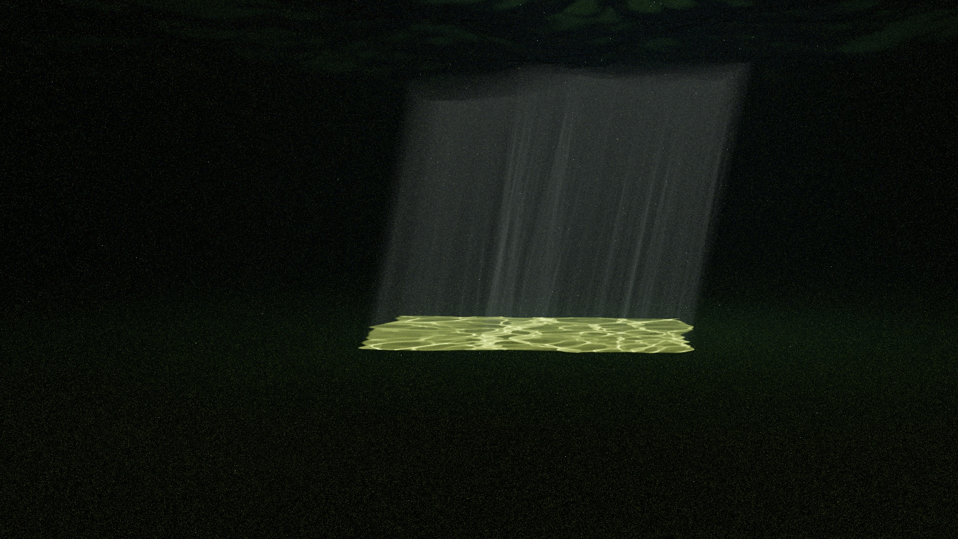

You simply have so many intermingled volumetric caustics in front of each other that they mix together into a uniform mess.
Here is a rendering of your scene with a cover over the water, blocking all the sunlight save from a quadratic spot.
As you can see, you need to take away some caustics in front and behind the ones you want to show in order not to drown them out.
Or modify the water surface so they are focused stronger.
