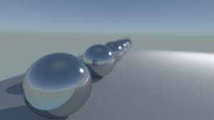

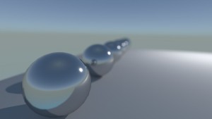

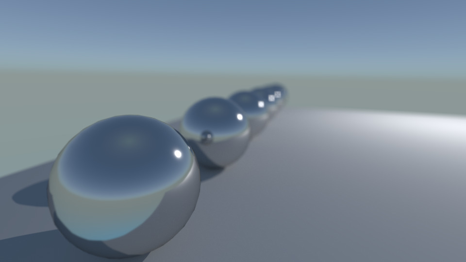

The v2.5 branch has now the support for camera non uniform bokeh (from issue https://github.com/LuxCoreRender/LuxCore/issues/409).
It can be enabled with the following camera properties:
# Number of camera blades (must be > 3 to enable bokeh)
scene.camera.bokeh.blades = 6
# NONE, UNIFORM, EXPONENTIAL, INVERSEEXPONENTIAL, GAUSSIAN, INVERSEGAUSSIAN or TRIANGULAR
scene.camera.bokeh.distribution.type = EXPONENTIAL
# Distribution power, 0 or more, affects only EXPONENTIAL and INVERSEEEXPONENTIAL distributions
scene.camera.bokeh.power = 0
# For anamorphic bokeh, the scale vector is normalized (so the length doesn't matter)
scene.camera.bokeh.scale.x = 1
scene.camera.bokeh.scale.y = 1
They affects only perspective cameras.
It can produce many types of bokeh effects:
Old LuxRender wiki has a quite comprensive explanation of bokeh: https://web.archive.org/web/20161014045 ... ld_of_View
