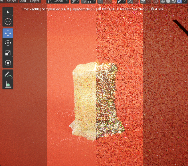

Just came to the forums to report some crashes/weird stuff and saw this thread. I think it might be related.
Using CUDA as well, but I think the behavior is the same with OpenCL. I also have two cards, an RTX 2070 Super and a GTX 1060. The 2070 is the main card, that is the one which I have the monitor connected to.
So, in the scene I uploaded, if I disable Light Tracing the viewport render is split in half, with half of it looking more noisy than the other. See the attached picture.
Sometimes disabling it causes Blender to crash.
Even if I disable Light Tracing with the viewport render off and then start the viewport render, it will crash or have this weird half image issue.
Rendering normally seems to work fine, it's just the viewport render that has problems I think.
However, if I disable the 1060 from the device list, this problem seems to disappear. And in fact, the viewport render is more responsive as well, I think, with the 1060 disabled.
I just downloaded the last 2.4 build and it's the same.
Thank you.
