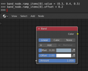

Ok, This is the result of my script! Last question: How can I change the colors of slots?
I've tried "ramp_node.ramp_items[0].ColorRampItem = (0.4,0.2,0.0)" but it didn't work.
Re: Simple shaders from python script
You should use gamma = 1 for the roughness map.
Like this:
Now it works!
Thank you so much!
