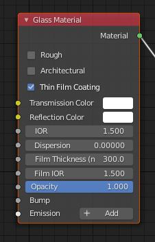

I have added support for thin-film interference to the following materials:
  • Glass
  • Arch. glass
  • Rough glass
  • Disney
It can be used for oil slicks, soap bubbles, oxid layers on heated metal, car paint, anti-reflective coatings, beetle carapace etc.
The resulting colors depend on the thickness of the film, the refractive index of the film, and the angle between surface and viewer.
BlendLuxCore
In the Blender addon, the "glass" and "disney" nodes now have a "Thin Film Coating" checkbox.
If enabled, you can specify the thin film thickness (in nanometers) and the IOR of the coating material with two new sockets.
On the disney node, there is an additional "Film Amount" socket so you can mix in more or less of the film effect.
LuxCore SDL
The textures to control the film appearance are defined with the properties
scene.materials.<material name>.filmthickness = 300  # in nanometers
scene.materials.<material name>.filmior = 1.5
The disney material has the additional property
scene.materials.<material name>.filmamount = 1
which is the linear interpolation factor between no film and film.
