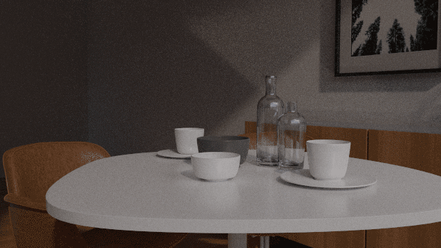

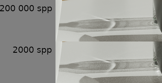

mischterlampe wrote: Thu May 07, 2020 10:54 am Nonetheless, the caustics of the glass bottle are very weak
The sun is at scale 4. With scale 1 and clamping off, caustics are stronger.
This is Ryzen 3900x equivalent to 1 hour
Border render

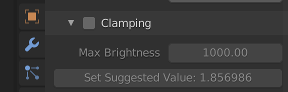

After rendering first with auto setting the calculated luminance would be saved and shown in the UI (similar to suggested clamping value in BlendLuxCore).
If it looks ok I switch to manual and use the saved value persistently for all further renderings such as of an animation.
Re: The flickerfree animation challenge
epilectrolytics wrote: Mon May 11, 2020 8:46 pm After rendering first with auto setting the calculated luminance would be saved and shown in the UI (similar to suggested clamping value in BlendLuxCore).
Luminance is not constant across different frames.
