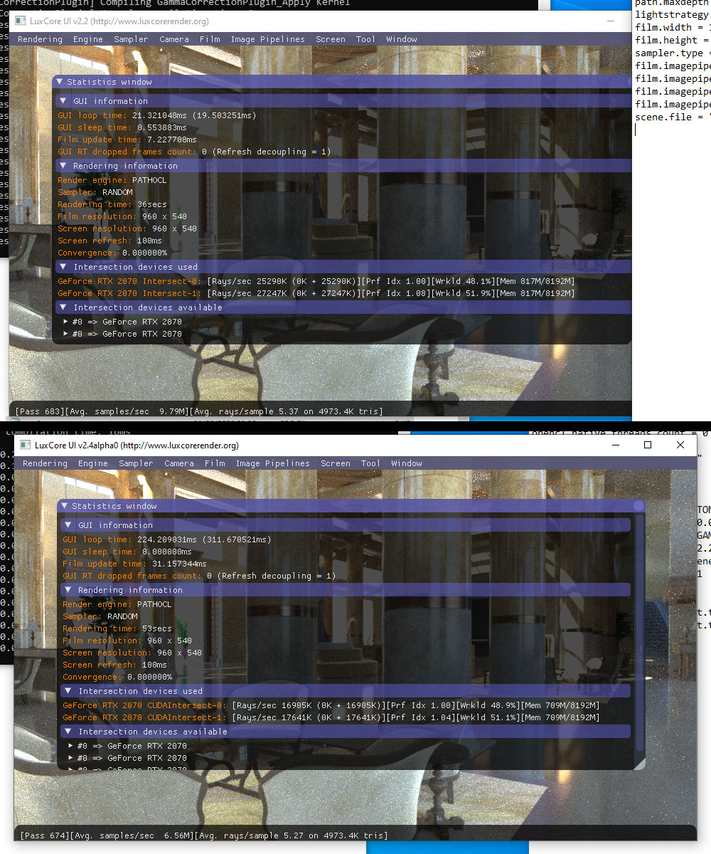

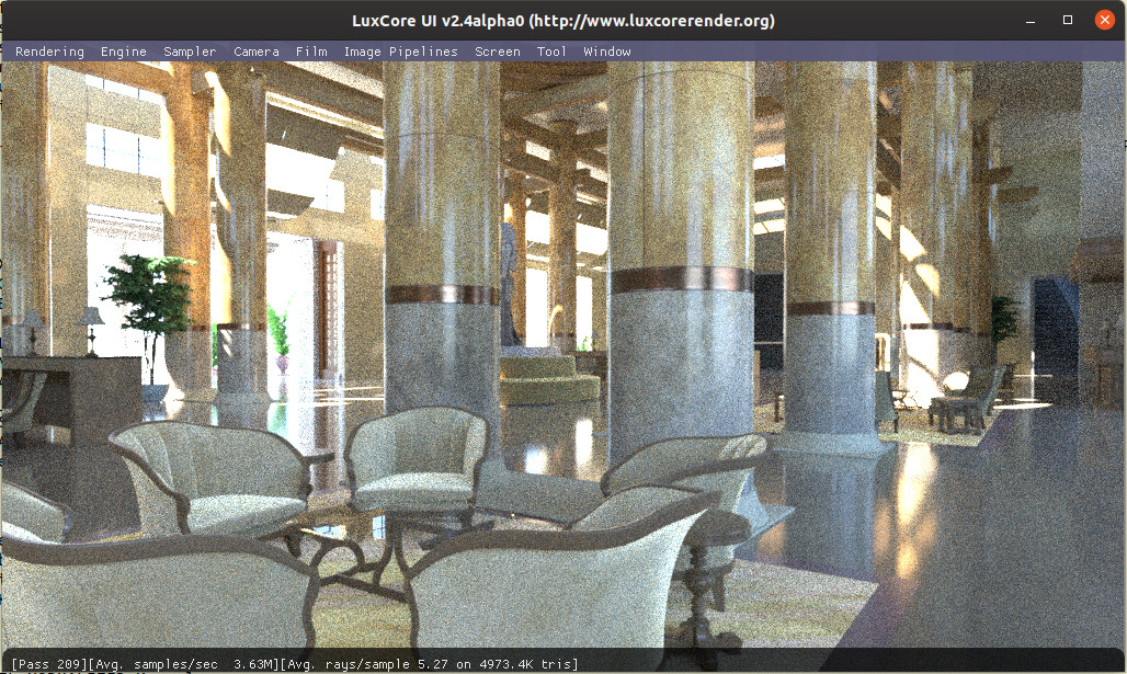

We are a bit chasing a "ghost". The difference is huge in very simply scenes while, more complex is the scene, and smaller is the difference up to the point where v2.4 starts to become faster. This is the LuxMark "Complex" benchmark scene (about 5,000,000 triangles) with v2.3:
and this with v2.4 with CUDA and cache-friendly Sobol settings:
V2.4 is faster even without factoring kernel compilation. Note that this "Complex" scene is using 719MB out of 8GB of my RTX 2070 (so it isn't exactly "Complex").
This pattern is going to become even more noticeable with RTX where the benefit are likely to be noticeable over 5,000,000+ triangles and significative over 10,000,000+ triangles.
For the above reasons, it doesn't look like is worth going trough all the trouble of re-implementing conditional compilation just to render simpler scene faster.
