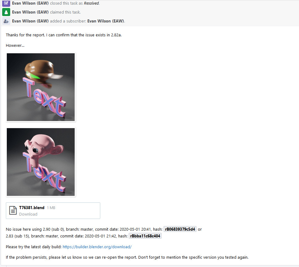

Heu maybe i will change. because in the mean time this happen.
https://developer.blender.org/T76381
No issue here using 2.90 (sub 0), branch: master, commit date: 2020-05-01 20:41, hash: rB06839379c5d4 or
2.83 (sub 15), branch: master, commit date: 2020-05-01 21:42, hash: rBbba11c68c404
Please try the latest daily build: https://builder.blender.org/download/
If the problem persists, please let us know so we can re-open the report. Don't forget to mention the specific version you tested again.

But the less invasive way will be to use 2.82a with cycles node. ;) . As the fix work in 2.83 and 2.90 i should avoid additional instability with unofficial build.
Re: BlendLuxCore Development
Sharlybg wrote: Mon May 04, 2020 11:16 am As the fix work in 2.83
It's in 2.83? That's great to hear.
tested with 2.83. it work in final render but not in viewport (i mean hiting spacebar "animation play" don't update). and also it doesn't display keyframe in timeline.
