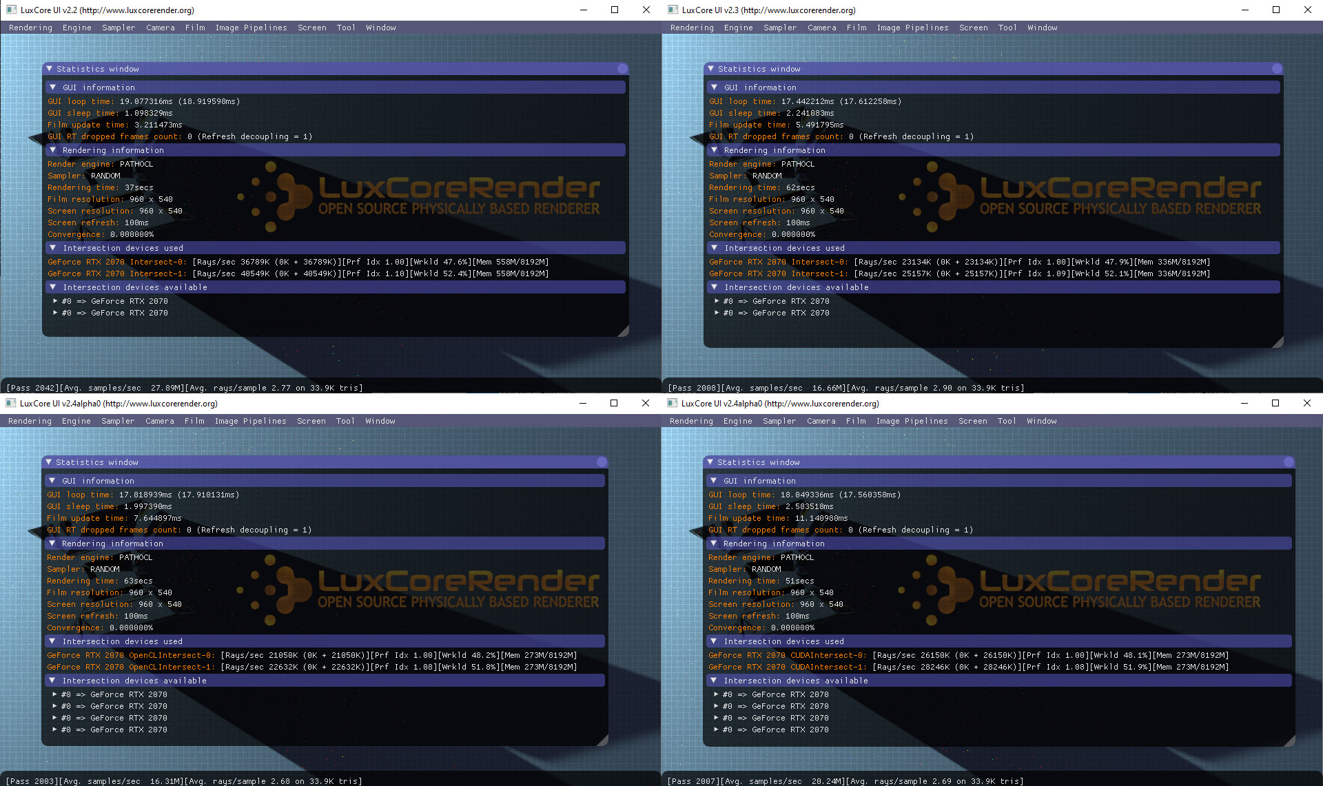

OMG I forgot to compare against v2.1!!
It renders even faster than v2.2
![Surprised :o](./images/smilies/icon_e_surprised.gif)
But only a little bit
Rendered with no PGI (didn't exist in v2.1).
Now I dare not to try v2.0 . . .
A very striking comment on the current effects of Corona on the economy:
DHL is a german parcel service slowed down heavily (like a Porsche hitting the brakes) by the fact that with most shops closed down everyone orders their stuff via internet and they have not enough employees...
__________________________________________________________________
![Shocked :shock:](./images/smilies/icon_eek.gif)
![Very Happy :D](./images/smilies/icon_e_biggrin.gif)
![Laughing :lol:](./images/smilies/icon_lol.gif)

Why not jump straight back to the first release of SLG and be amazed.
Features cost performance, some less, some more, but almost none are free.
However, I'm still interested in the reason for the big difference between v2.2 and v2.3.
