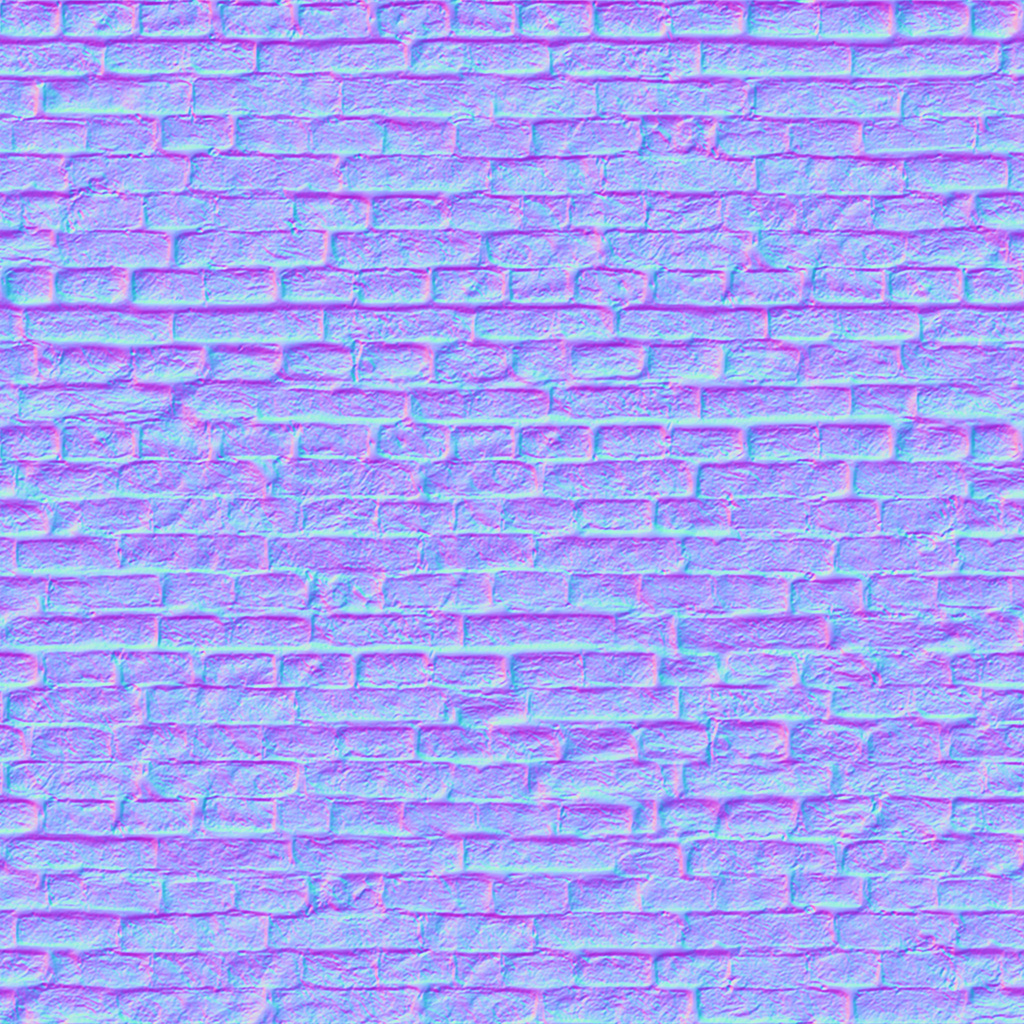

This is how I add an image as a texture map then add it to normal texture and finally apply it to the material.
scene.textures.Map_2.type = imagemap
scene.textures.Map_2.file = E:\Brick_Normal.jpg
scene.textures.Map_2.mapping.uvscale = 1.0 1.0
scene.textures.NormalMap_2.type = normalmap
scene.textures.NormalMap_2.texure = Map_2
scene.textures.NormalMap_2.scale = 1.0
scene.materials.Material_2.normaltex = NormalMap_2

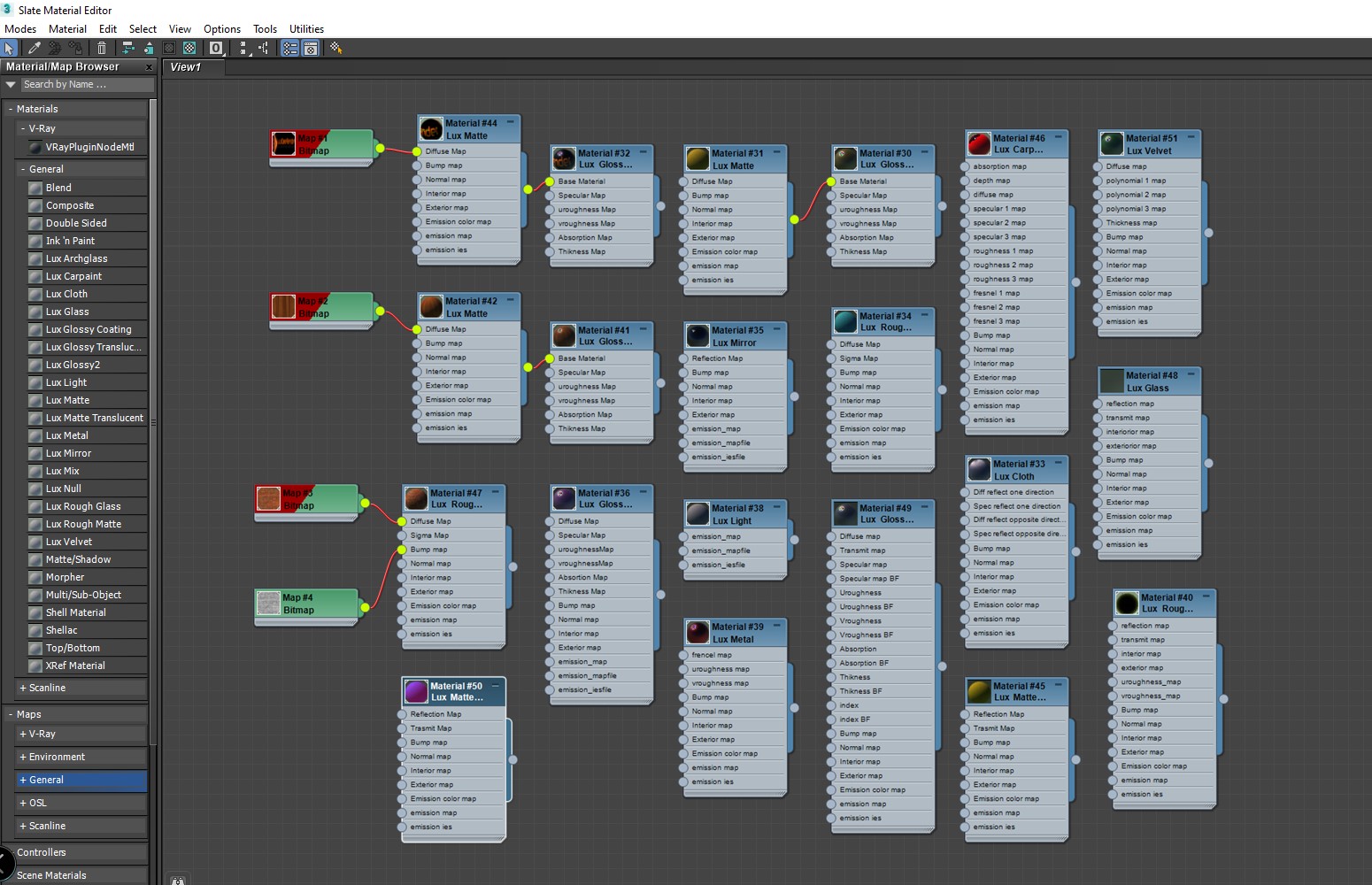

Re: MaxToLux - 3ds Max Integration for LuxCore
Just a simple material test and its work as it's intended to.
Of course, there are a few issues and material work only one level deep in sub materials and sub textures part for test reason.
Also, I will publish a new build today.
Odd bump and normal bump behavior still persist.
There is a conflict between 3dsmax gamma and LuxCoreRender Gamma.
At this moment I'm working on 2d and 3d textures that completely necessary to be done to create more complex material and shaders.
There are too many textures and I'm a bit busy with no one to help so it may take a bit of time but I'll gonna try my best.

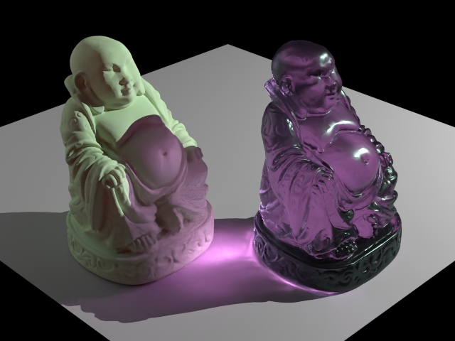

Another material test with a simple caustic effect and more.
