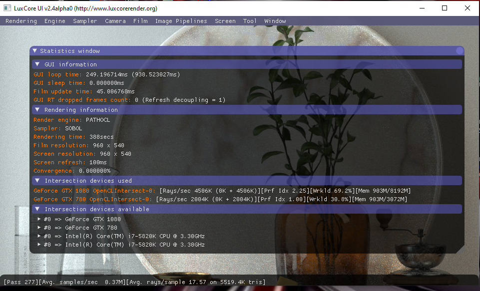

Yes, OpenCl compilation works now but I have another question. I downloaded the latest azure build and the OpenCL build is as fast/slow as my build. I see the expected speedup of cuda, too. Which is good on first sight but it is approx. 2x slower than the 2.3 build. What is the difference of the new framework compared to the old one in v2.3? Is this normal behaviour?
Food scene with LuxCoreUI v2.3:
Food scene with LuxCoreUI v2.4alpha0 OpenCL build:
Food scene with LuxCoreUI v2.4alpha0 CUDA build OCL devices:

No and, as far as I know, it happens only to you, to start, try check if it is the scene, your version looks like a very old one and it is likely to use the BCD denoiser. BCD is a peculiar beast that require a lot of (GPU) ram. Try some other scene (and be sure to disable BCD, it is enabled in most old .cfg).

Check your screenshots: the GUI loop time is 18ms in v2.3 and 250ms in v2.4 there is something very wrong going on :?:

Yes, the scene was old. But with new scenes (i.e. food and danish mood) and disabled denoiser I get similar performance values. At least the GUI loop time is down to ~20 ms.
If no one else has this slowdown problems I will investigate it on my side. It has no high priority. I thought that you had an spontaneous idea what could be the root.
