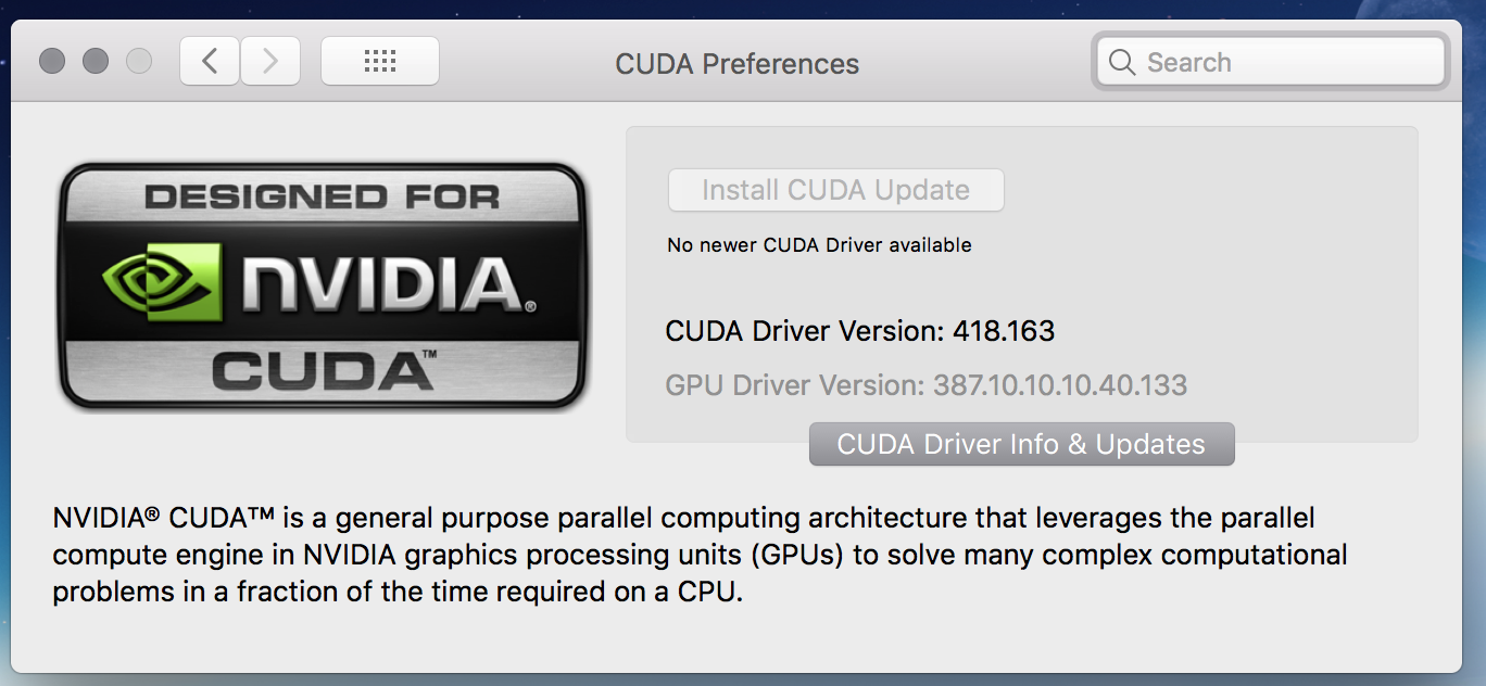

u3dreal wrote: Wed Apr 29, 2020 9:19 am Can you run blender from terminal and post the output ?
Sorry for being so dense but I have no Idea how to use the terminal, there's zero UNIX knowledge.
If you post me a string I will type it in and we'll see what happens :lol:
I'm behind with the driver but it says "no newer driver available" ?

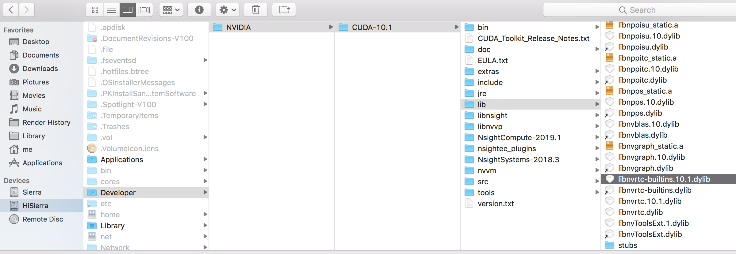

This is the CUDA installation:
Update:
I'm pretty sure your higher driver number results from CUDA 10.2 instead of 10.1 toolkit installed!
Going to try...
acasta69
Posts: 472
Re: PATHGPU with OpenCL and CUDA support
Post by acasta69 »
Version 418 seems compatible with 10.1 toolkit, see here:
https://docs.nvidia.com/cuda/cuda-toolk ... index.html
Versions are not shown for MacOS, but I guess major number cannot differ too much.
If you build with toolkit 10.2, you are probably going to need an updated driver.

Posts: 818
Post by epilectrolytics »
epilectrolytics wrote: Wed Apr 29, 2020 9:37 am I'm pretty sure your higher driver number results from CUDA 10.2 instead of 10.1 toolkit installed!
Going to try...
Nonsense.
CUDA 10.2 comes with a 440.xxx driver and then the add-on asks for the 10.1 lib, so no success.
But I cannot find where the 418.243 comes from?
In nVidia's archive the 418.163 is the highest available.
Restored to pre-cuda state, but kept the 10.1 dmg in case... :lol:

It is not a driver problem, the DLLs are included only in NVIDIA CUDA SDK so or they are included in BlendLuxCore (like on Windows) or you need to install CUDA SDK.
Posts: 818
Dade wrote: Wed Apr 29, 2020 11:19 am It is not a driver problem, the DLLs are included only in NVIDIA CUDA SDK so or they are included in BlendLuxCore (like on Windows) or you need to install CUDA SDK.
Yes, I have the SDK installed and the DLL (dylib on a Mac) is there but the add-on cannot find it on my machine but it does on u3dreal's machine...
If it is only this single library including it in BlendLuxCore OSX would be preferable than needing a 4GB SDK installation (smaller install is possible, but beyond my skills).

There are 2 DLLs used: nvrtc and nvrtc builtins.
