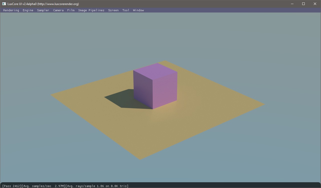

- Compiled latest (1d8818b34) /cuda:
Build succeeded.
0 Warning(s)
0 Error(s)//// CUDA is not available yet.

opencl.devices.select = 0011and "Compiling" took forever = Kernels compilation time: 155375ms but when it showed up was already @ 2412 samples -
Also note: OCL too, takes foooreeveeer to compile now
