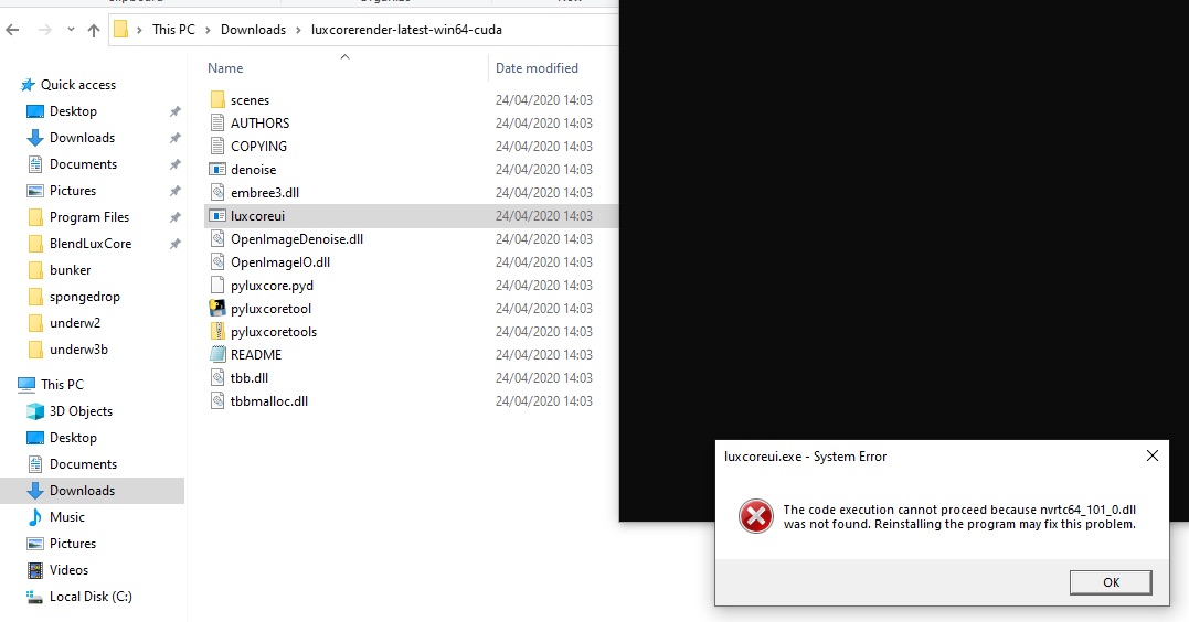

acasta69 wrote: Fri Apr 24, 2020 9:54 am At the moment the CUDA build is working for me and also on Azure.
Thanks for your effort!
When looking into the "latest" releases there are now three windows versions: CUDA, OCL and non-OCL.
When trying to open LuxCoreUI from the CUDA version I get this:
PC with Win10Pro1909.
Of BlendLuxCore there is no separate CUDA version.
Sorry I don't know anything about building myself, just want to give feedback on the latest releases on Azure.

Indeed, there is something still to be fixed: gathering the required dll for for cuda version is not working at the moment, I am looking into that.

acasta69 wrote: Fri Apr 24, 2020 12:48 pm Indeed, there is something still to be fixed: gathering the required dll for for cuda version is not working at the moment, I am looking into that.
According: https://docs.nvidia.com/cuda/nvrtc/index.html
The requirements on Windows are:
- nvrtc64_Major Release VersionMinor Release Version.dll
- nvrtc-builtins64_Major Release VersionMinor Release Version.dll
@KintuX, as work around, you can install CUDA SDK v10.1.
I was assuming NVRTC (Run Time Compiler) was included in NVIDIA drivers but I guess, it isn't. This could be annoying.

Yes, those are the two files I was trying to retrieve from the Cuda installation, and they are not included in the drivers.
