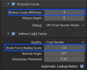

Re: First Try
Casper wrote: Tue Apr 21, 2020 3:06 pm - PhotonGI Cache with Photon Depth = 3 (vs 8). Is not possible for me to choose 2 or 1, 3 is the limit min of the value.
I think you have confused photon depth with brute force radius scale.
Re: First Try
Sure !
they are both at 8 by default but the one you should change to 1 or 2 is Brute force radius scale ( this one have a major impact on performance). So leave photon deph at 8.

Re: First Try
Post by Casper »
Yes,
With Brute Force Radius Scale 8 to 2 : Result is good with less noisy than original, Render Time is 5:07:08
With Brute Force Radius Scale 2 to 1 : Result is good with less noisy than original, Render Time is 5:08:67 (same quality compare with value 2)

Re: First Try
Post by Casper »
With Photon Count (Millions) 10 to 3, Result is good (noisy), time render is 04:44:55.
