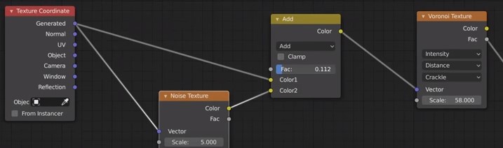

Is it possible to add noise to a vector, like in the attached image (Cycles)?
Thank you
Thank you
Re: Repeating Textures
Currently not, but it's something I'd like to have eventually.
