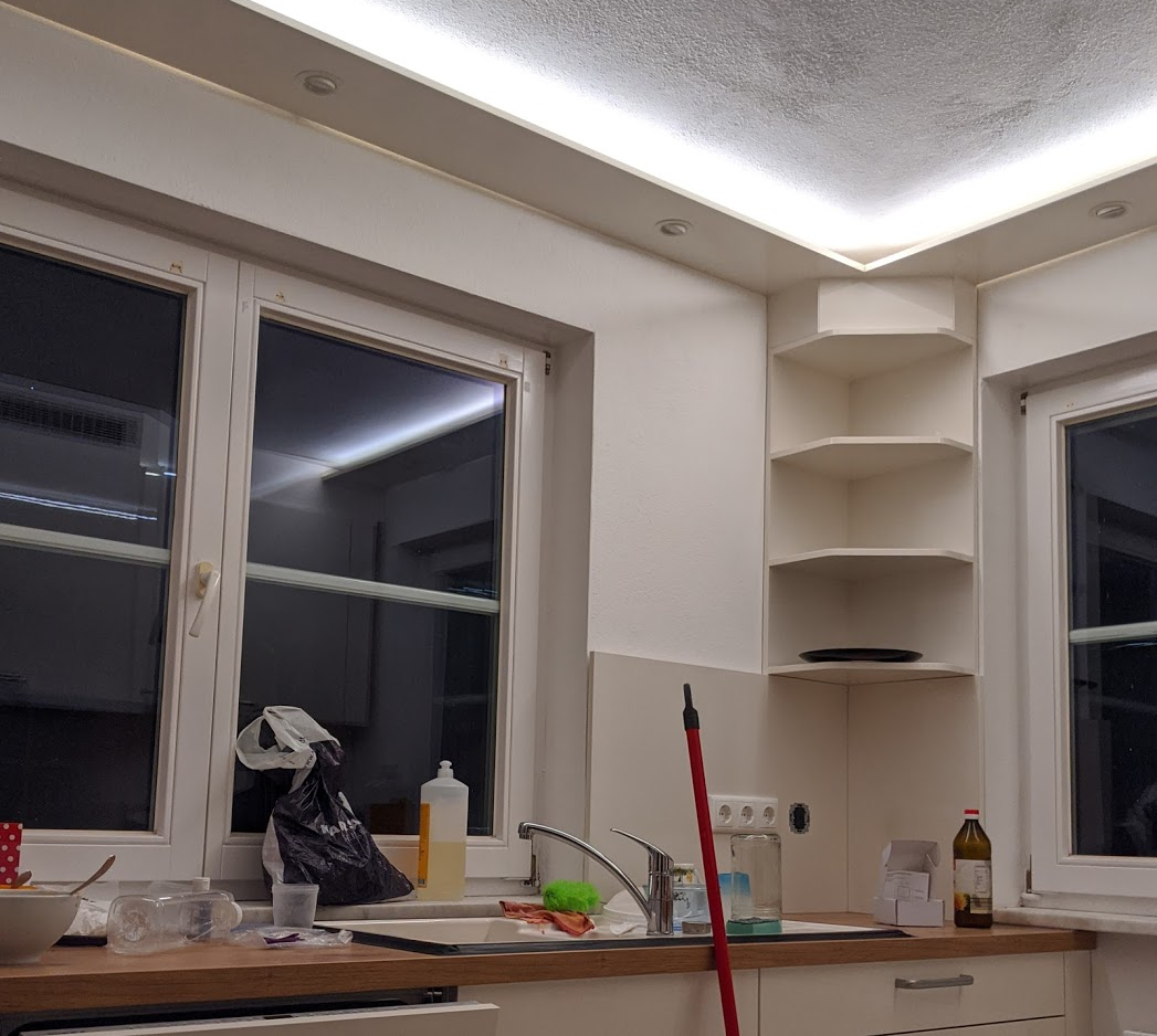

Sorry for 'reopening' this thread, but I wanted to give some feedback from the real world.
After initially playing around with luxcore I wasn't able to put more time into this in the depth it would require. So thanks a lot for the recommendations, CodeHD and FarbigeWelt. I went with your suggestions to "the luxcore rendered image is too dim", crossed two fingers, ordered and installed the stripe and wasn't disappointed. I was looking for min-requirement "mood light" and in full light you can work on most things relatively well.
For other folks to have an idea of what the real world scenario is, please look at the attachement.
The LED stripe I used was advertised as
Temperature: 3.000K
Brightness: 1.150 lm/m
180 LEDs per running m
("Color range" / "Farbwiedergabe": High CRI>90)
It was installed into a alumnium casing behind a plastic semi-translucent cover. This was claimed to have a light-pass trhough rate of 65%.
The photo was taken from a smartphone (Pixel4) with:
ƒ/1,73; speed 1/100s; ISO 103; lense 4,38 mm
HTH and thanks again for luxcore :)
Real world 'render'
Real world 'render'
Posts: 528
Re: Indoor light simulation: LED stripe for indirect lighting
Great to hear it worked. Nice to see some real-world feedback! :)
