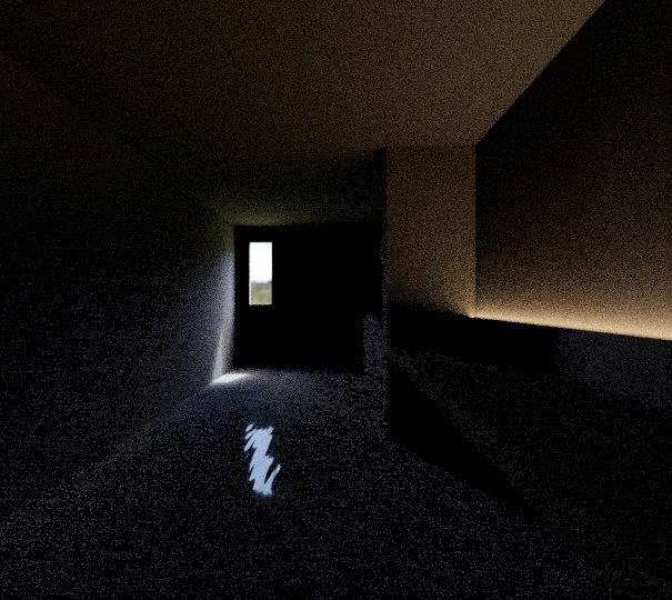

Result are noisier and darker while using Envcache.How
Just trying to reproduce the behaviour with a simpler scene.

This is my tests
Env Cache OFF
Env Cache quality 0.5
Env Cache quality 1.0
Enc Cache quality 0.1
						Env Cache OFF
Re: 2-Levels Env. Light Visibility Cache
Most noise in this scene comes from indirect light, which is not accelerated by env. light cache (use PhotonGI instead).
