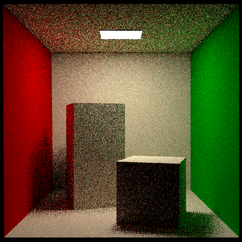

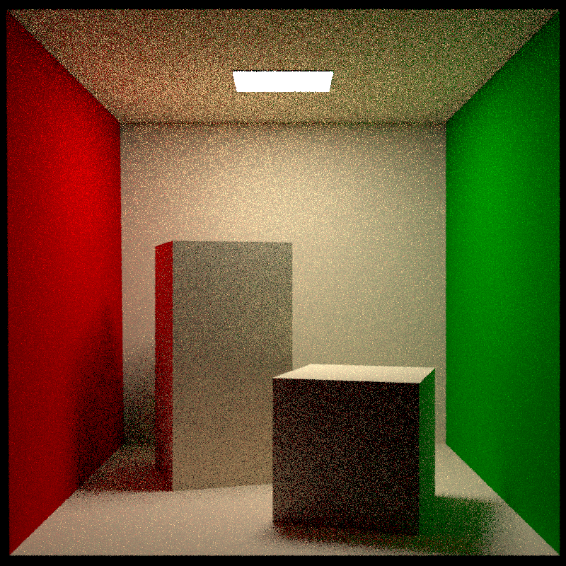

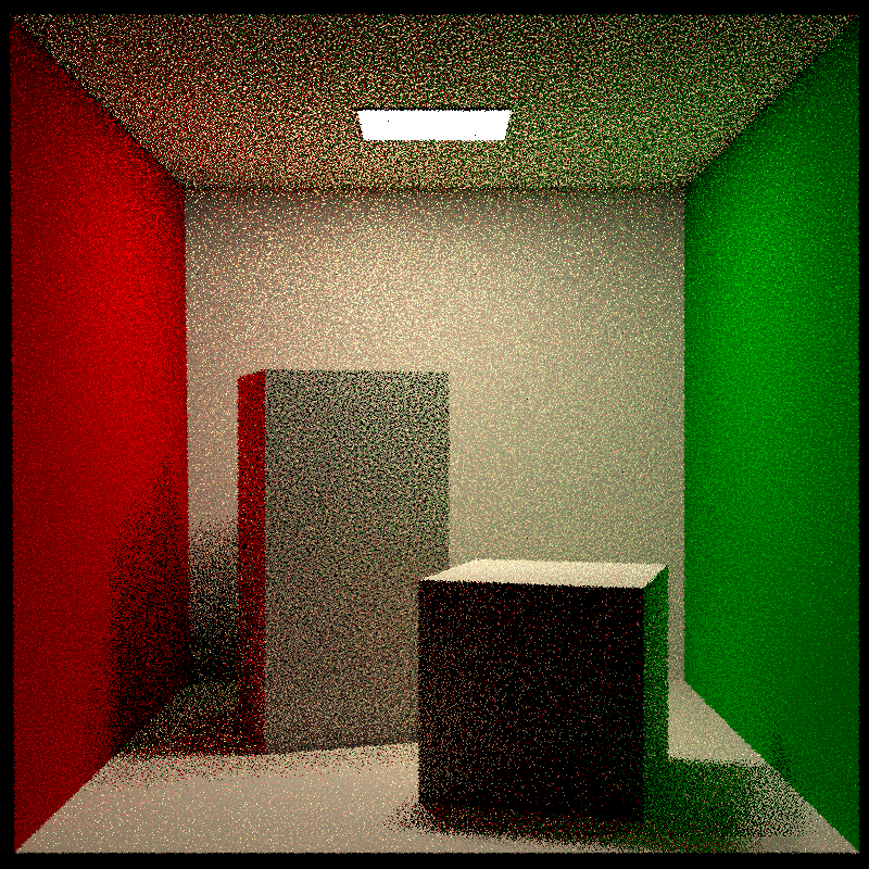

Comparison:
At 1spp:
At 4spp:

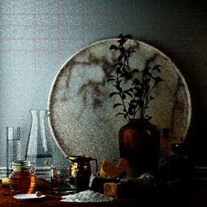

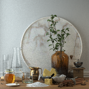

The improvement is only for very low sample counts.
I can see that the pattern is a bit more pleasing, but it is not a huuuge deal.

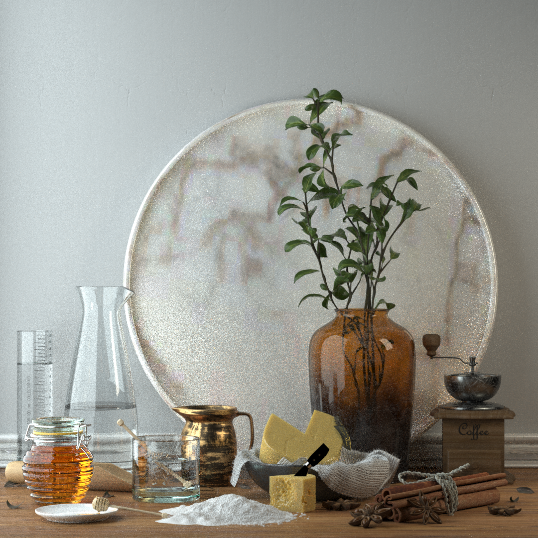

I actually made the newer paper method work:
(Besides having the blue-noise properties it also uses Owen-scrambled Sobol points, so it should have somewhat better convergence properties, mostly on smooth gradients)
16 spp: 128 spp: I am using the new method for the first 256 samples and then revert to the usual one.
About the correlation issue, do you have a specially problematic scene for me to test?
Re: Blue noise dithered Sobol
The reflections on the glass seem to have much less noise in the new method.
I'm seeing some repeating patterns in the noise in the upper left.
But I'm unsure if this is caused by the sampler or by the wall bump texture, I think it was tiled in this old version of the scene, although I don't think the tiles were this small. You could try the updated scene where the wall texture is no longer tiled: https://github.com/LuxCoreRender/LuxCor ... romage.zip
The both sampling are tiled over 128x128 pixels, so it is completely reasonable that there are correlation artifacts.
I will download the new scene to test.
About the noise, it is most likely due to the Owen scrambling. I saw the same effect when using my PMJ02 patch

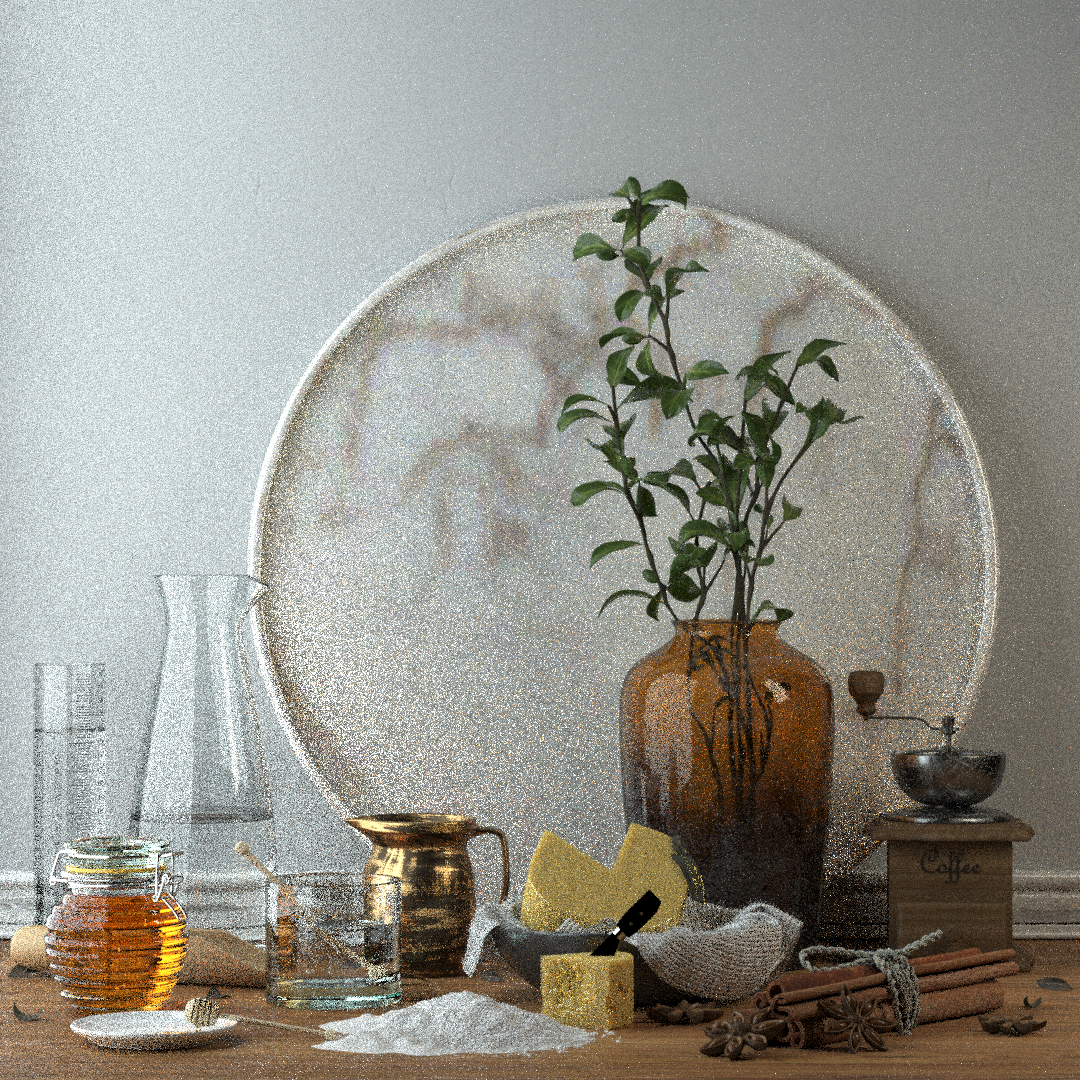

Now I've hacked it into my PMJ02 patch:
I'm doing the same thing we do with the current sobol samples. Applying the Cranley-Patterson rotation to the samples but using the blue mask.
According to the Siggraph "My favorite samples" panel we have to apply this rotation but only inside each stratum, so there might be some margin for improvement here
16 spp: 128 spp:
16 spp: 128 spp:
In the examples you show I don’t see the same effect as in cycles at all, there must be something different because with Cycles you can see the "gif" effect in no time, meanwhile in those tests the dithering effect is barely present, so something is off with the implementation, may be because of the way Lux samples lights? Because Insee a lot of noise from the light in the Cornell box example, but there is something definitely wrong with this.
Do you have at hand the blend file for the Cornell box? I would like to try to reproduce the example with the exact same scene, because the benefit is way more than the one visible here, definitely.
BTw thanks for looking into this
