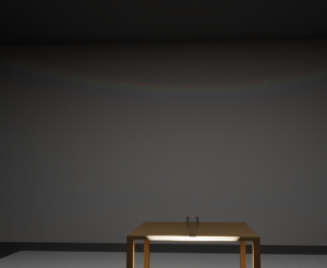

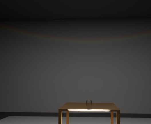

Circumhorizontal arc
wasd
Posts: 319
Post by wasd »
cza.zip
(104.01 KiB) Downloaded 369 times

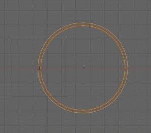

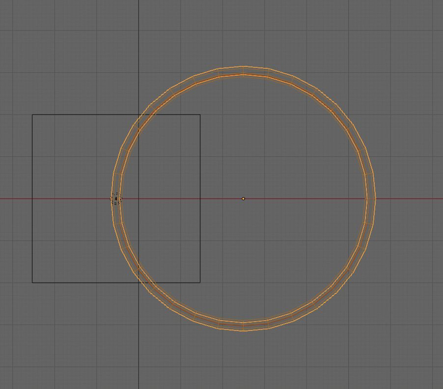

CodeHD wrote: Fri Mar 13, 2020 10:19 pm Looks odd with the offset water to the glass. Was this effect intended or by accident?
No, it wasn't intended. That's what happen when some genius in blender dev decide that it's good idea to select and move with same mouse button. In a piece of software where you can't even group objects.
Ok, I moved water back in place and arc disappeared :) It was glass out of place, so I moved them both closer to wall and arc reappeared.
wasd
Posts: 319
Re: Circumzenithal arc
Post by wasd »
Also, it's not circumzenithal arc, it's circumhorizontal.
Circumzenithal would be on the floor if glass lighted from it's side.
