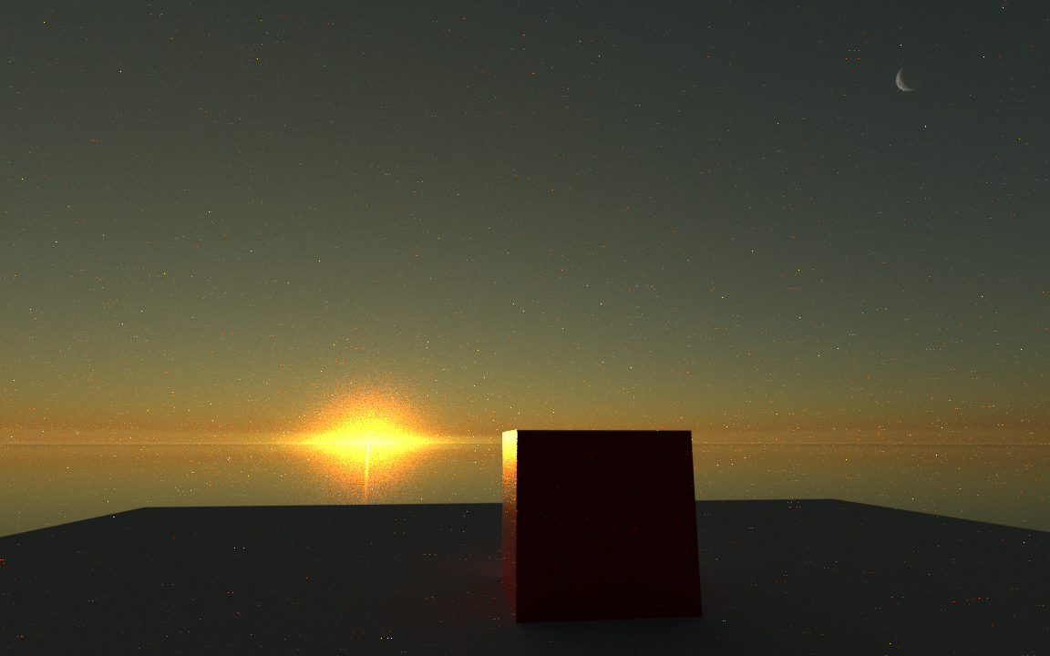

I have disabled scattering on all atmosphere layers, then re-enabled it one by one to find the one responsible for the fireflies, and it looks like the "Glare" layer is the sole culprit.
It seems to be caused by the high Asymmetry: Values higher than about (0.7, 0.7, 0.7) seem to increasingly create fireflies, and the glare layer has asymmetry (0.93, 0.92, 0.92). Can the volume scatter code be optimized to better sample such strong directed scattering?
(4 minute renders on RTX 2080 below)
Scattering in glare layer enabled
Scattering in glare layer disabled
