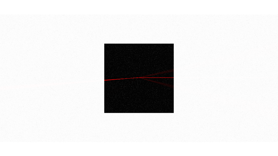

Updated test scene + render, with a distant source to illuminate the rest of the volume, showing a new observation:
In the transparent part of the volume, there are white values >100, while in front of the black object the peak is around 30, and mean much lower. As the homogeneous volume is limited, there should not be values higher than twice the black area, which is about in the middle of the volume.
A reference stripe looking outside the volume at the top and bottom is fine.

You seem to assume that scattering is a linear process, it isn't, it follows an exponential law.CodeHD wrote: Wed Mar 04, 2020 9:31 pm Updated test scene + render, with a distant source to illuminate the rest of the volume, showing a new observation:
Re: Transparent background, threshold level
But in this setup with a low scattering scale compared with the dimensions of the volume, we should not observe that. Even if, the light is coming from the direction of the camera, so the second half of the volume should then be darker and contribute less than what is seen over the black object.Dade wrote: Wed Mar 04, 2020 9:59 pm You seem to assume that scattering is a linear process, it isn't, it follows an exponential law.
