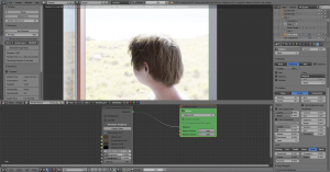

Hair renderings are different between viewport render and actual rendering.
Post by SlowHand »
In viewport, hairs are smoothly rendered, but not in real rendering.
Tessellation type is solid with 8 sides.
Blender 2.82
Blendluxcore 2.3RC1
Viewport rendering
Actual rendering

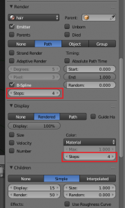

There was similar trouble in 2.79
You had to set both "steps" parameters to equal number to have hair rendered as they are in viewport.
I can't see that another "step" in 2.8 though.
Upd: Found it. Try setting them to equal number.
SlowHand
Posts: 11
Joined: Sun Feb 09, 2020 12:39 pm
Re: LUX Girl
Post by SlowHand »
wasd wrote: Wed Mar 04, 2020 11:59 am There was similar trouble in 2.79
Thanks, wasd.
It works perfectly.
