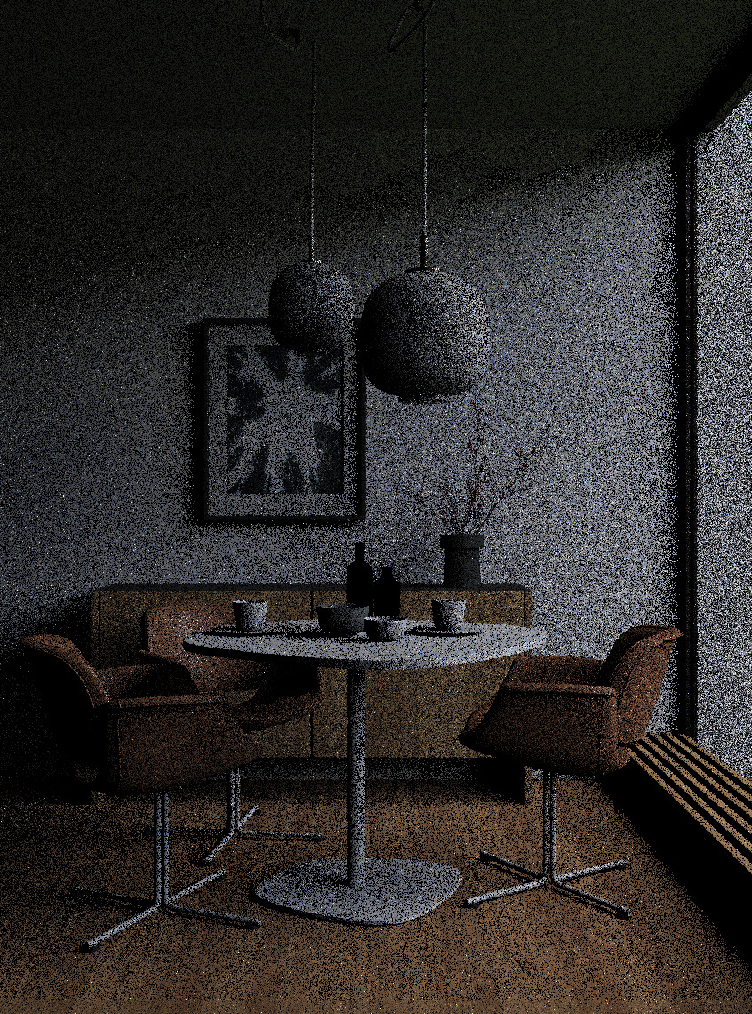

An 1 samples/pixel without any cache (only importance sampling):
An 1 samples/pixel with old Env. Light Visibility Cache:
An 1 samples/pixel with new 2 levels Env. Light Visibility Cache:
Note: all 3 methods are unbiased and converge to the correct solution on the long run.

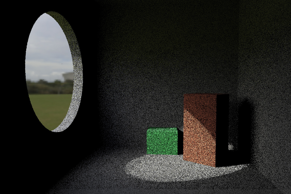

This is a 1 sample/pixel render with low quality setting and few millisecond of pre-processing:
This is a 1 sample/pixel render with high quality setting and and about 10 seconds of pre-processing:
