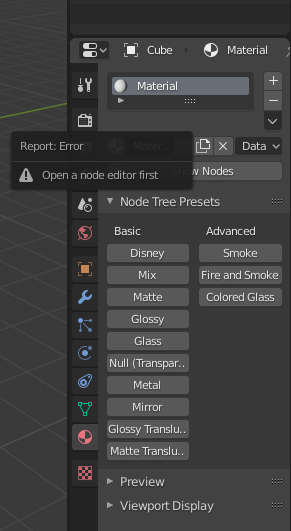

Sorry to write again, but still hours on, am getting no where. Attached is screenshot asking for node editor which is nowhere to be found. Looked at all the manuals....the illustrations in the Luxcore are for the old Blender UI...the present Blender manual has no coherent indication what to do to pull up the material node editor. The Blender interface at present is really badly designed...just to get quick GPU renderings for materials hardly seems worth it...but what do I know?
Glendaloch
Posts: 23
Joined: Fri Jul 06, 2018 8:35 pm
Re: Can't Get LuxCoreRender to work with Blender MacOSX
Post by Glendaloch »
attached screengrab

Fox
Posts: 437
Post by Fox »
There is good interface tutorial from Sharlybg
https://www.youtube.com/watch?v=XjwCOIWwQo4
