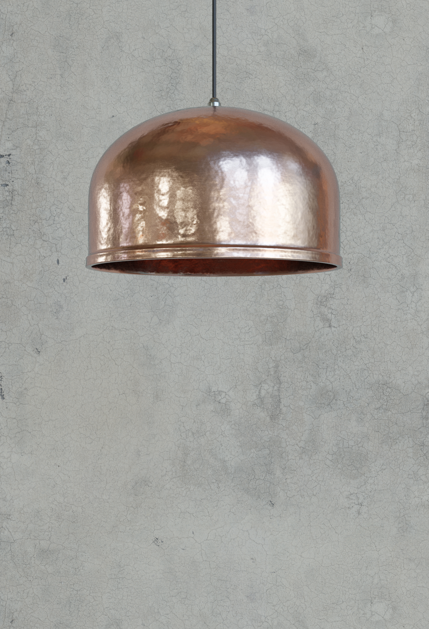

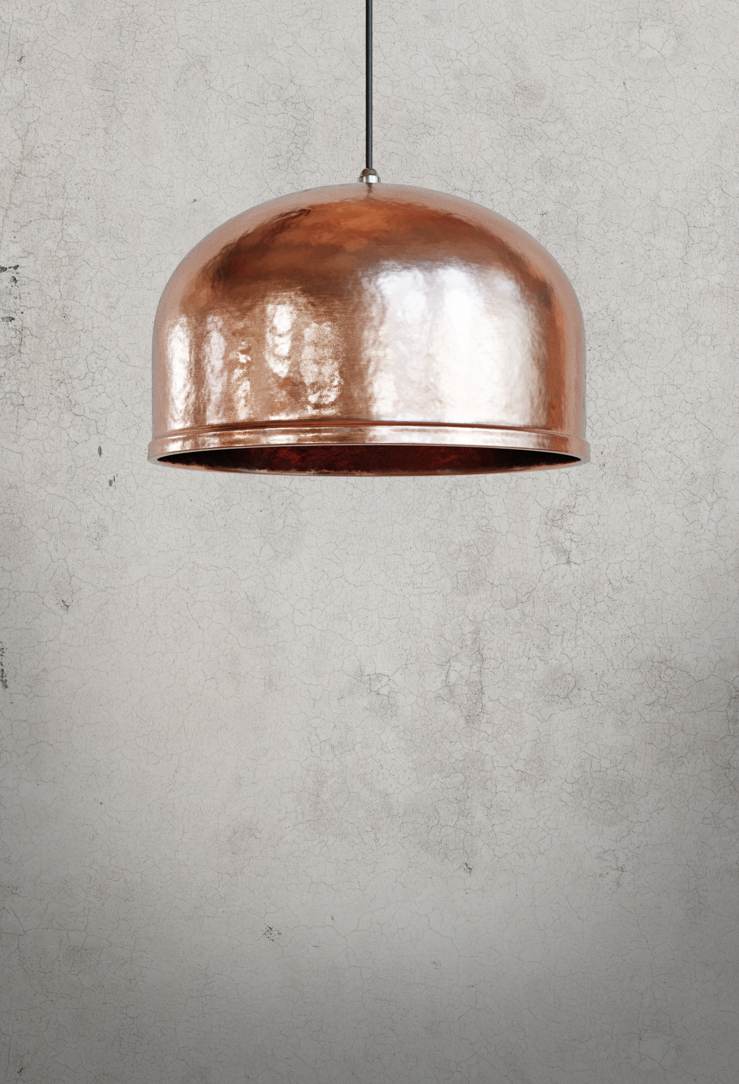

This is a WIP I'm working on, I was inspired by the amazing work of Jakub cech

Hi welcome ! First really like the Lamp it is very well done considering your hardware specs. Anyway as you are on budget build this is my advice.
