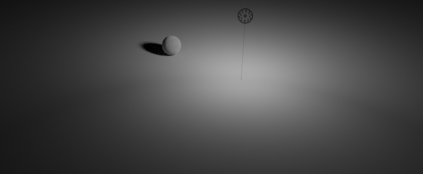

I simplified my scene setup and switched to 2.23 to try the new units.
The scene is real simple - a one candela point light one meter over a plane, with everything having diffuse white materials. The scene is attached.
When I do a render with the irradiance pass enabled, I get around 0.25 under the light's position for irradiance in an unknown unit type, although irradiance is typically in W/m^2 or W/cm^2.
Going back to the above image, this 0.25 should somehow be able to be converted to 1 lx, but based on the math I see on the subject, I can't figure out what conversion would take me there. Also note that the caption for the image is incorrect and should read illuminance since it deals with lux.
There also happens to be some kind of view-dependent ring on the ground if sigma is anything but 0.0 on the diffuse material:
I'm also using the Photographer addon and when setting the exposure to 0EV (9.610 in Exposure under Color Management), the one candela light looks about correct - which means the actual illuminance must be close to 1 lx...just can't get the numbers I want in the irradiance pass.
As verification, if I set up the same exact scene in UE4 with a one candela light, I get exactly one lux of illuminance on the ground under the light.
validation.blend
(667.43 KiB) Downloaded 950 times

polyrhythm wrote: Thu Feb 27, 2020 2:10 am I'm also using the Photographer addon and when setting the exposure to 0EV (9.610 in Exposure under Color Management), the one candela light looks about correct - which means the actual illuminance must be close to 1 lx...just can't get the numbers I want in the irradiance pass.
Let's ignore Photographer for now, as I don't trust it to be perfectly correct yet (I will be running more accurate tests for the next version, with the physical light units).
I think the answer is there: viewtopic.php?f=4&t=802#p8585
As Dade mentionned in that post, for the irradiance pass, he uses 179 lm/W as " the standard luminous efficacy of equal energy white light that is defined and used by Radiance. It can be used here to produce the same output of Radiance. More information here: http://www.radiance-online.org/pipermai ... 03616.html".
However, outside of that Radiance reference, I've never seen 179 lm/W being the standard luminous efficacy anywhere. Maximum luminous efficacy is obtained by a green light a 555 nm, and this is 683 lm/W. Especially when using Normalize by Color luminance, that 683 lm/W will make sense as it will compensate for the loss of brightness of colored lights that are not green.
We assume power to lumen using 683 lm/W, which explains why it's darker than expected in the irradiance pass. 683/179 = 3.816, which is oddly close to the 0.25 brightness you measure (1/3.816 = 0.262).
The irradiance pass should probably be corrected to use 683 lm/W as the standard luminous efficacy :)
EDIT: One thing that is odd is that the World Flat Color light which supposedly outputs Lux is rendering fine in the Irradiance view... Could it be that it also assumes a 179 lm/W ?
