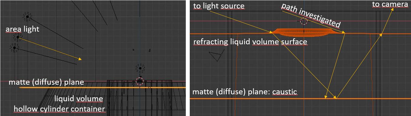

Now, for a small research project related to my latest project ("Bubble optics", https://www.osapublishing.org/ao/abstra ... ao-59-1-45), I am currently trying to investigate a particular caustic occuring below floating surface bubbles floating on a liquid as cast on a screen below the bubble.
To this end, I have modelled the outer and inner bubble meniscus (the bubble cap being thin and almost non-refracting) in Blender and wanted to investigate the caustic with LuxCoreRender. After reading some posts in this forum I realized that this is a setup which causes some problems as it is of the type SDS (specular - diffuse - specular) since both the camera as well as the light source are exterior to the liquid in which the caustic is cast (see image of the setup, attached. Also the scene is attached.). (The scene is similar to a pool caustic scene, and indeed you can observe bubble caustics in a pool on a sunny day.) Hence, no light tracing nor bidirectional tracing are possible.
I have still managed to get the caustic as expected using an area light (a disc source with 5 times the solar diameter, hence blurring the caustic but increasing efficiency) + path tracing. Also, I could quickly get the desired caustic to render using the PhotonGI caustic cache feature.
However, my aim is to learn about the ray paths responsible for the caustic under certain conditions (incident light angle, depth of the "pool"). To do so, my hope was to use:

I am trying to qualitatively understand the contributions to the caustic stemming from multiple possible ray paths. The difference between those paths would be a difference in the number of specular interactions with the meniscus (e.g: simple single refraction only ray path, or a ray path traversing the meniscus like a prism before subsequently being refracted by the outer meniscus = 3 specular reflections, or a refraction followed by an internal reflection = 2 specular interactions). It is for this reason that I am interested in the exact count logic.Dade wrote: Tue Feb 18, 2020 2:41 pm Sincerely, it is impossible to follow all this +1-1+3-4-etc. I suggest you to go to square zero: are you trying to measure the amount of light received by a surface, including caustics ? Not by the camera (like in a normal rendering) but by a (matte) surface![]()

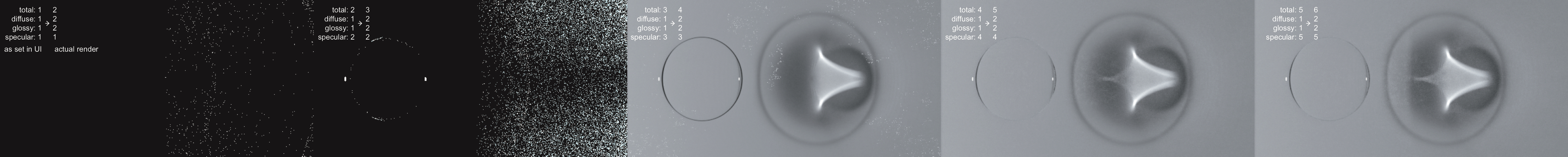

Attached is a sequence of renderings (path tracing, no PhotonGI) with increasing total + specular depths.
I would still like to understand why I only start to see the SDS caustic with a depth setting (as set in the UI in blender) of (total = 3, diffuse = 1, glossy = 1, specular = 3), whereas I only see tinted (my volume has this color as the absorption color) sprinkles with depth settings in LuxCoreBlend v2.2 (the blender UI) set to (total = 2, diffuse = 1, glossy = 1, specular = 2). As I understood from B.Y.O.B. the former setting amounts to an actual rendering with (total = 4, diffuse = 2, glossy = 2, specular = 3), whereas the latter to (total = 3, diffuse = 2, glossy = 2, specular = 2).
The latter setting should be enough to reveal the caustic (well, half of it: the far side cusp) as it should render camera - specular - diffuse - specular - (area light) paths, at least if neither the camera nor the light nodes are counted as is suggested in the documentations?
