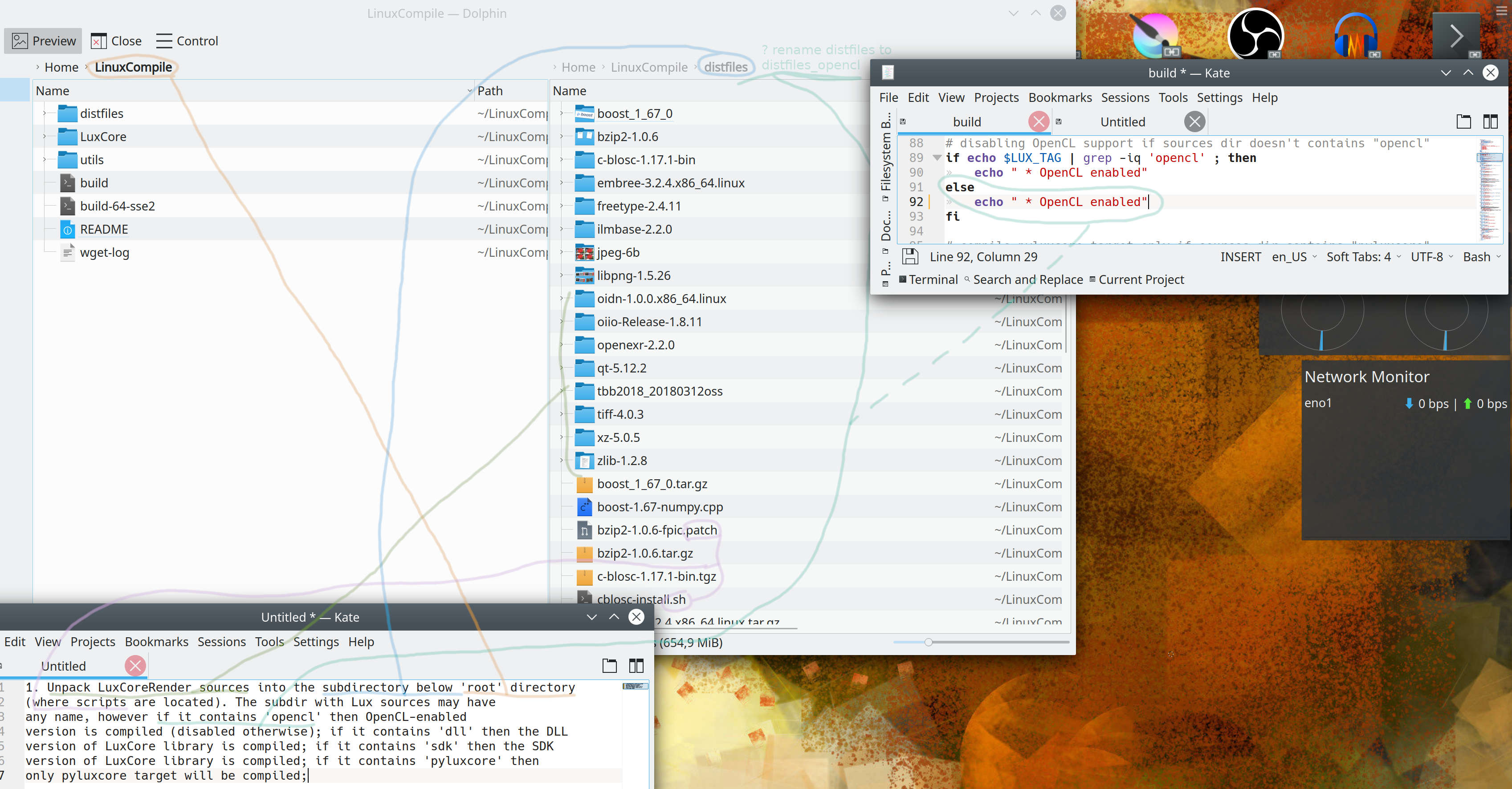

I have the feeling your "opencl" (wrong name) is just empty
This part is not mentioned in readme. Readme tells to create empty folder named opencl.Dade wrote: Mon Feb 10, 2020 11:21 pm Have you done a "git clone" of LuxCore repository as explained in the README file ? You should do a git clone on a "LuxCore-opencl" directory.
I have the feeling your "opencl" (wrong name) is just empty![]()

Nope, from the README:Fox wrote: Mon Feb 10, 2020 11:51 pm This part is not mentioned in readme. Readme tells to create empty folder named opencl.
1. Unpack LuxCoreRender sources into the subdirectory below 'root' directory
(where scripts are located). The subdir with Lux sources may have
any name, however if it contains 'opencl' then OpenCL-enabled
version is compiled (disabled otherwise); if it contains 'dll' then the DLL
version of LuxCore library is compiled; if it contains 'sdk' then the SDK
version of LuxCore library is compiled; if it contains 'pyluxcore' then
only pyluxcore target will be compiled;
Yes it's the same one that i studied hard:Dade wrote: Tue Feb 11, 2020 12:39 am1. Unpack LuxCoreRender sources into the subdirectory below 'root' directory
