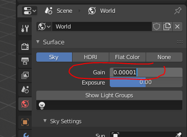

when you put render and this happens
Blendluxwhite.blend
(552.73 KiB) Downloaded 353 times
Full Hybrid Back/Forward path tracing - I don't like clamping - Bidir it's great but very slow - I have 4096 MiB de Vram and I want to cry.
Re: Blender 2.81a with Luxcorerender 2.3beta1
The default light intensities have not yet been tuned after the change of the tonemapper defaults.
In this case the sky is too bright, lower the gain to compensate.
I hope I can improve the defaults before the final release of v2.3.

IMHO I think it's better to leave the sky values untouched and work with the camera Gain Value, it will make much easier to work with the lights and the sky/sun will feel more natural, I think that at least :)
Correct me if I'm wrong @B.Y.O.B.
It doesn't really matter if we tune the sky gain down or the tonemapper gain down.
My goal is to make the lights compatible with Cycles and Eevee by default, so users can switch between the engines seamlessly.
