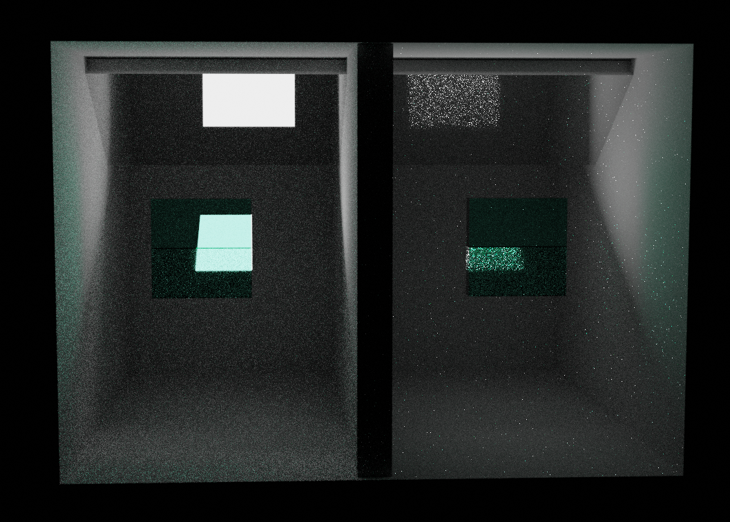

Re: lights behind glass
kintuX wrote: Mon Jan 20, 2020 1:57 pmset Opacity to 0
The problem about this is that you lose MIS.
This becomes apparent in glossy reflections/refractions like metal or rough glass.
In the attached scene there are two mesh lights: in the left half, with opacity = 1 and camera visibility disabled, in the right half with opacity = 0. The glass in front of the lights has shadow color white and the lower half is rough glass.
You can see the problems showing up in the form of undersampled glossy reflections (in the metal on top, and as fireflies from unresolved reflected caustics from the metal) and undersampled glossy refractions (the greenish rough glass).
area_light_opacity.blend
(924.58 KiB) Downloaded 1096 times
lacilaci
Posts: 1969
Post by lacilaci »
B.Y.O.B. wrote: Mon Jan 20, 2020 5:00 pm
Hm, any idea how cycles solves this issue? Cause I haven't seen any performance issues there with such features.
lacilaci wrote: Mon Jan 20, 2020 5:51 pm Hm, any idea how cycles solves this issue? Cause I haven't seen any performance issues there with such features.
I guess they have a different implementation of material transparency/opacity. It's a question for Dade if the LuxCore system could be changed in a way that allows MIS to work for fully transparent emissive materials.
