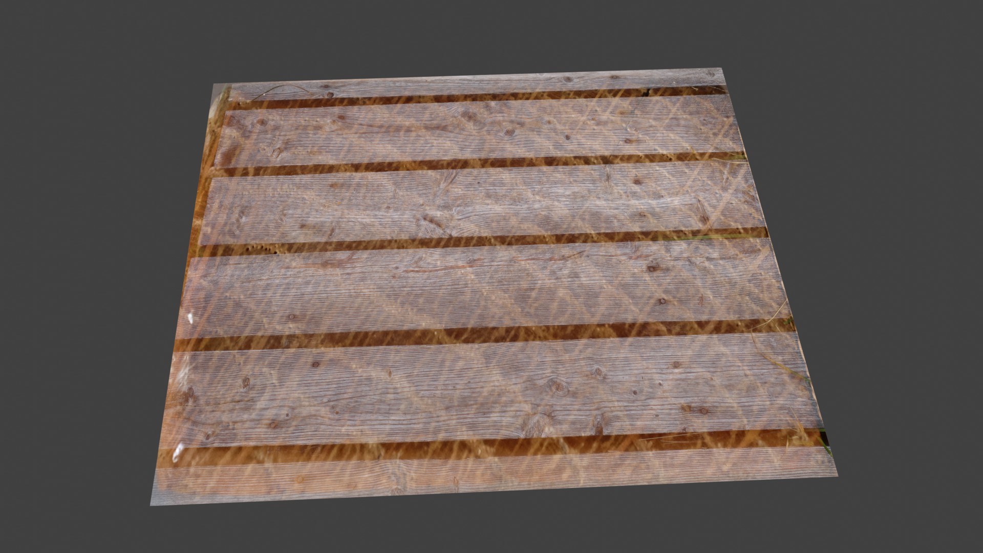

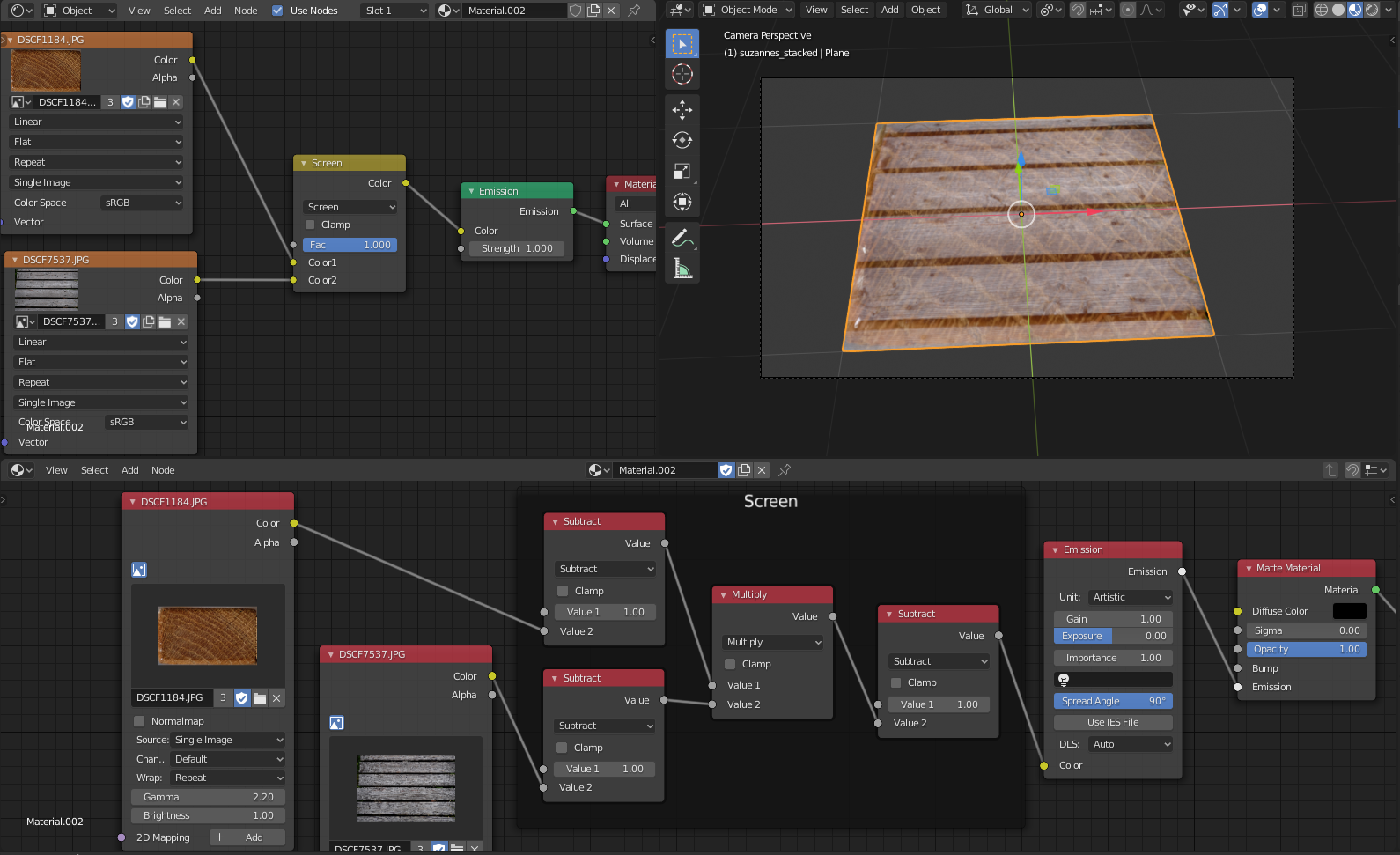

For the time being, you can build it out of basic nodes.
The operation can be found here: https://photoblogstop.com/photoshop/pho ... -explained
result = 1−(1−A)×(1−B)
Node setup, upper left Cycles, bottom Lux:
