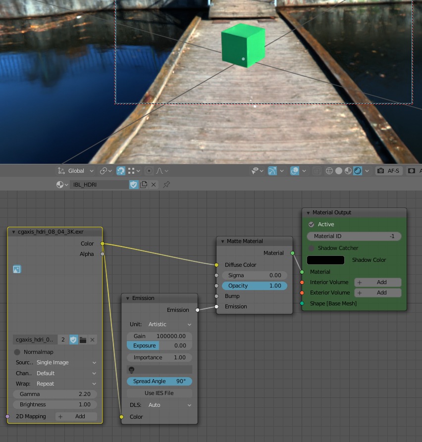

You can apply HDRI tex to the sphere (making it an emitter) with UV spherical mapping. Then manipulate sphere scale/rot/pos to your liking.
Here's a simple scene to check
IBL_HDRI_mnpl.blend
(98.07 KiB) Downloaded 988 times
Thanks kintuX! That is what I've tried with the sphere but I couldn't solve two things:
- It looked very "dull" when I applied it in comparison to the result I got using the HDRI slot in the world tab (even after playing a bit with the gamma and brightness) I might solve this one fine tunning it a bit more.
- The second thing I couldn't work out is how to make the sphere not appear in the camera but only in the reflections (also avoid self casting shadows). This is mainly to get a correct Alpha channel to later use for the composition. As I remember this feature will be released in the next version, right? Or is there a way to do it with the current one?
I'm trying to understand what it is: it looks like some kind of field view angle that work only for HDR (a bit strange).
It is working as kintuX showed. It seems to be projected over a sphere that you can control its size, Z position and rotation. You can see in the very first seconds when it gets really small that it has the shape of a sphere.
