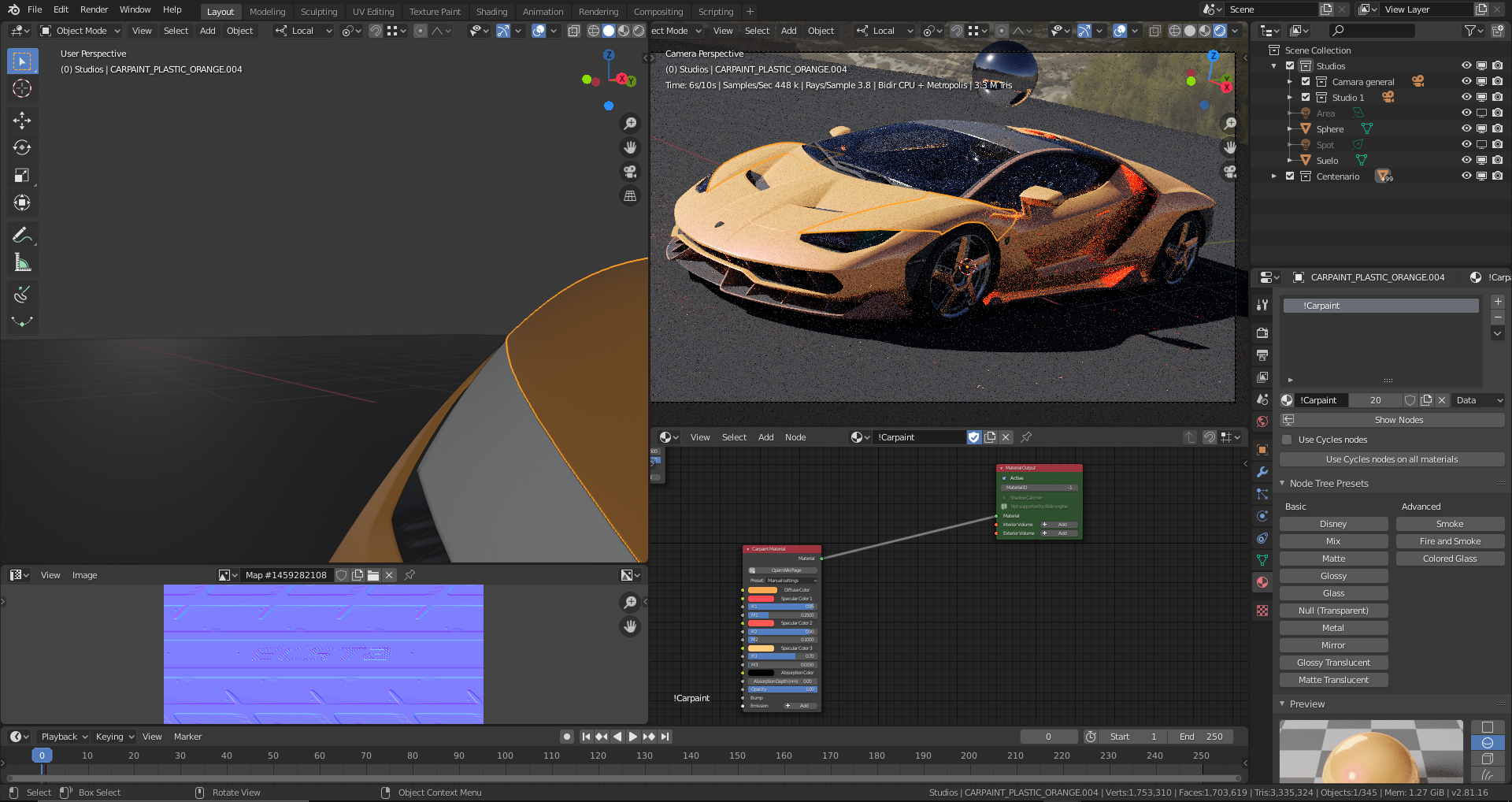

- I've been trying to use a background image to do some compositions. However it doesn't load the image (it appears all black). I'm using the Path method at this moment. Am I doing something wrong? I tried with a smaller size version of the image and it didn't work. - Is there any way to control just the IOR of certain materials (specialy the Disney one, which I believe is like the principled BSDF luxcore version)? I'm trying something with the glossy coatting material, and it kinda works but maybe there is a simpler way. It is to control de Fresnel effect of the car paint.
- The car paint seems to be bugged. Apparently there it doesn't "stop" to bounce the light. I tried by using the clamp option and reducing the amount of max bounces but it didn't have that much of effect and it made the rest of the image look bad. I decided to use a custom material node setup to use for the car paint in this ocassion.
Car paint My custom setup - Is there any way to deactivate shadow casting / reflection / etc of certain objects? The front light plastic is making the interior of the light look too dark and I might want to cheat a bit there.
- And lastly, is there any way to add multiple bumps? also luxcore doesn't support a drag and drop method right?

It should work, strange.PDRA wrote: ↑Thu Jan 02, 2020 7:54 pm - I've been trying to use a background image to do some compositions. However it doesn't load the image (it appears all black). I'm using the Path method at this moment. Am I doing something wrong? I tried with a smaller size version of the image and it didn't work.
Does it also happen in a simple (default cube) scene? If yes, can you upload the image so we can check if there's something wrong with it, or if it triggers some bug in LuxCore?
The IOR setting of the glossy coating material is just a more physically oriented way of specifying the reflection brightness (higher IOR = brighter reflections). On materials without this setting, you can just make the specular color brighter/darker to achieve the same effect, or in case of the disney material, change the specular value.PDRA wrote: ↑Thu Jan 02, 2020 7:54 pm - Is there any way to control just the IOR of certain materials (specialy the Disney one, which I believe is like the principled BSDF luxcore version)? I'm trying something with the glossy coatting material, and it kinda works but maybe there is a simpler way. It is to control de Fresnel effect of the car paint.
The colors you have set are too bright (100% brightness). Try making them a bit darker.
This wiki page might also help: https://wiki.luxcorerender.org/LuxCoreR ... Parameters
Not in v2.2, but in the upcoming v2.3 you will be able to disable shadow casting of objects.
In v2.2, you can try to use a glass material with the "architectural" option for the front light plastic, however this will disable refractions for the material, you'll have to judge if that looks OK.
You can add them with a math node set to "Add".
We can not support drag and drop because Blender does not expose this in the Python API (I would have liked to though).

Thank you BYOB for the detailed reply!
I have tried some of the things you said and it helped me a lot.
I will be trying the car paint and add bumps tips later.
I tried with a default cube and the background image didn't work. I attach a sample image for testing and a few viewport screenshots.
Somehow I'm sorting it out using Fspy but it is a bit odd because on the imported camera from Fspy I get the background but it overlays with the HDRI I'm using when I activate the render mode. To sum up I align it in solid view but I can't properly see how it would look in render mode (because it overlays or it doesn't appear).
FSPY camera works ok with solid view However it overlays the image with the HDRI Positioned a new camera but it doesn't shows the image Regards, saludos
