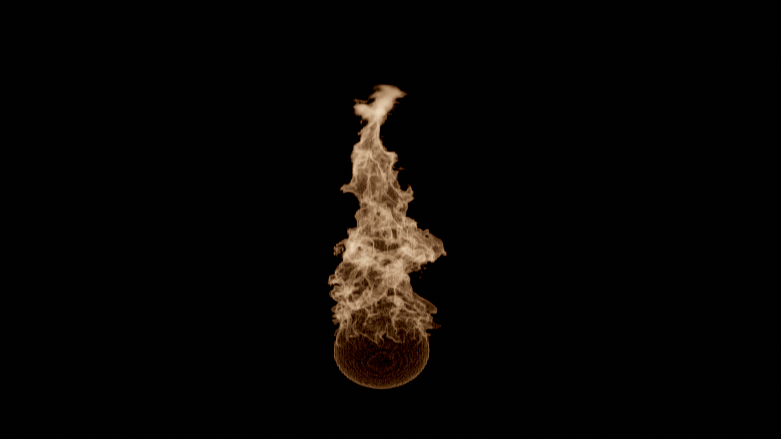

Hello! Thanks for this feature!!! I have done a little test of fire... in my opinion result is quite realistic.
Now i want to render an animation of this fire. It is a vdb sequence (460 frames).
In viewport fire changes frame by frame (everything ok). But after render i got many pictures with the same frame. So, how i can render animation of vdb sequence? Is it possible?

I found the problem and solved it. It was my mistake, sory... I set wrong frame range in render settings. But now i have another problem (maybe i do something wrong again). Now, my beautiful fire shakes. I think the cause of that can be box offset. VDB file was generated in Turbulance FD converter. I don't know how to packed VDB sequence in blend file, so i give it separately.

Thanks for the scene. There is a bug somewhere in the handling of the domain offset. I have to investigate what is going wrong. The smoke Export code needs to be adjusted to Blender 2.82 anyway. I just need to find time to do it.Rivental1 wrote: Sun Feb 23, 2020 9:26 pm I found the problem and solved it. It was my mistake, sory... I set wrong frame range in render settings. But now i have another problem (maybe i do something wrong again). Now, my beautiful fire shakes. I think the cause of that can be box offset. VDB file was generated in Turbulance FD converter. I don't know how to packed VDB sequence in blend file, so i give it separately.
