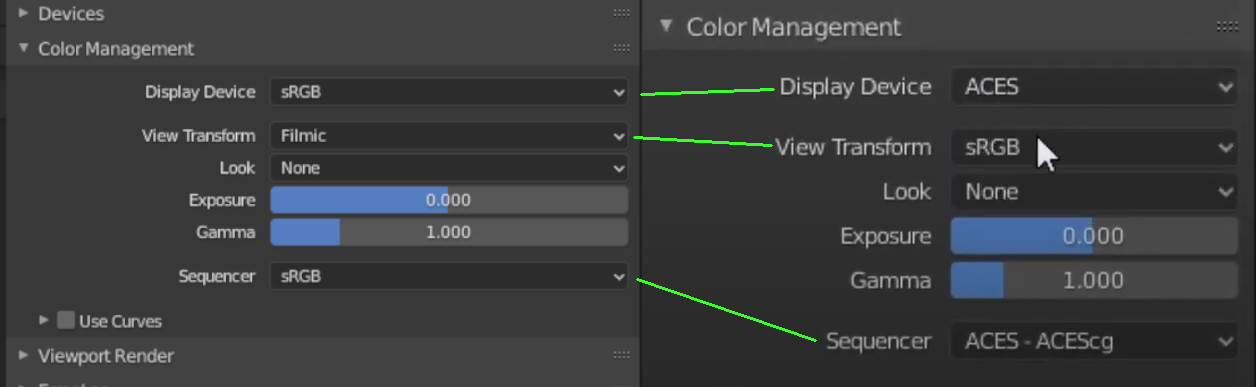

And from the blender Color management side this is how
People who tried to work in ACES in blender does it :

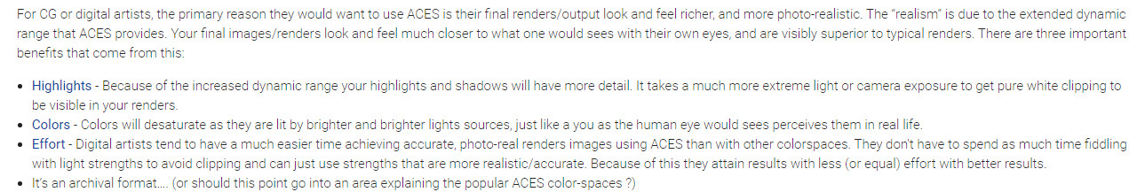

And for people saying ACES doesn't improve realism in render :
https://acescolorspace.com/
It really deserve the effort to implement it !

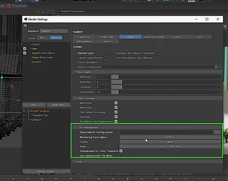

This are Vray and Redshift implementation of ACES
Redshift
