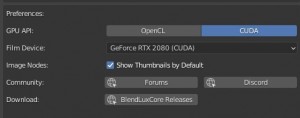

At v2.5 - if GPU contains RTX - is RTX\Optix automatically enabled in CUDA rendering? Because I can't see any checkbox today. (I read about changes, there is a note about force disabling Optix even if card support it)

DionXein wrote: Wed Apr 21, 2021 3:19 am is RTX\Optix automatically enabled in CUDA rendering?
Yes, it is enabled for all RTX GPUs and disabled on others (for instance GTX1080) because it is slower than our code in our tests.

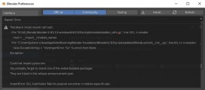

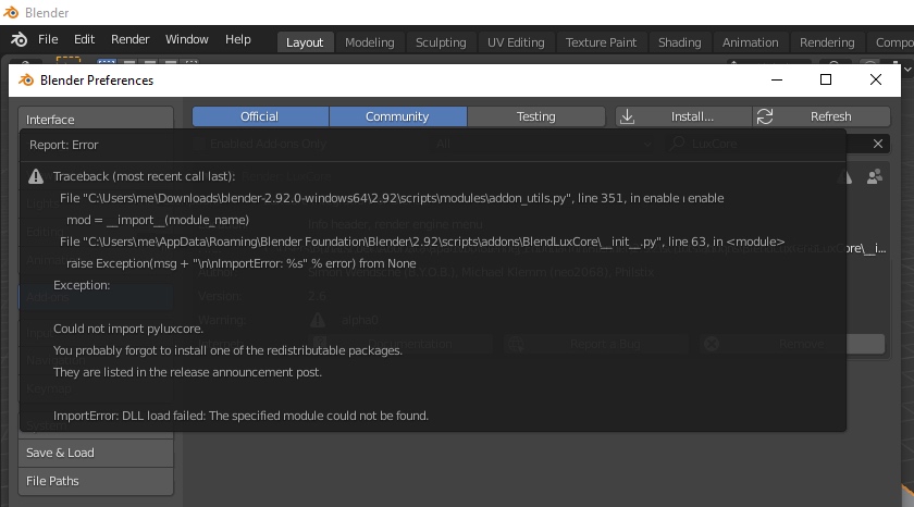

Somehow I cannot install the latest BlendLuxCore 2.6 alpha on Windows (screenshot below) or MacOS with Blender 2.92.
I have not Installed VS2019 because I saw it was reverted to VS2017.

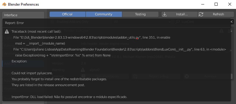

JulianoLisboa
Posts: 146
Re: LuxCoreRender daily/automatic builds
Post by JulianoLisboa »
I also can't install it on 2.83
acasta69
Posts: 472
Post by acasta69 »
I should have fixed this, some change was required because of upgraded libraries.
A new build should be ready in minutes.
I hope it works also on Linux, I have no way to check.

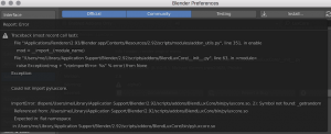

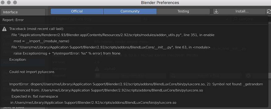

About MacOS I'm not able to help, sorry, but it's probably a different problem.

Now the Windows version works, thanks @acasta69 for the fix!
(MacOS 10.13 still defaults with error shown below:)
