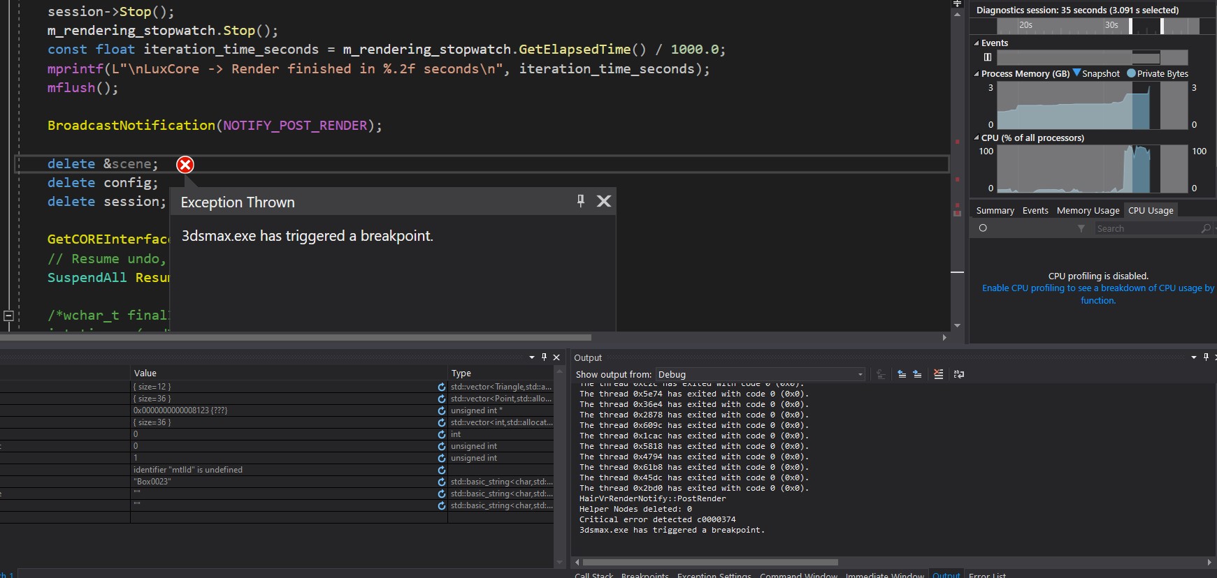

I noticed if I cancel the render too quickly normally before 50 passes 3dsmax will crash and the compiler will show me the error about "a heap has been corrupted" with a pointer on Luxcore::Scene and critical error number C0000374. The problem will appear just if I cancel the render too quickly or hit the render too many times. By the way, after 100 passes or so, never happened.
Not sure if this is related or not but if I compile all the codes with the optimization /Ox switch the problem will be less likely to happen and most of the time I will get no error at all.
here is the actual error in the compiler that may be useful.

I did not use DeleteSceneOnExit() function and changed the order of the delete session as you mention.
Delete &scene
is the last line and after that just resume all suspension in 3dsmax nothing more.
I need to add this, the error does not always mean crash, sometimes I will see the error but 3dsmax will not crash and function normally so if I'm not in debug mode I can not notice that all the time, just when the crash happens.
